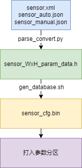

2.1 Flowchart#
The production flowchart is as follows:
Figure 2-1 Parameter Partition Production Flowchart
The production steps are as follows:
2.2 Production Steps#
2.2.1 Convert Header File#
Take sensor: IMX335, resolution: 2592x1944 as an example
Copy the parameter file to the directory for converting header files
Navigate to the conversion operation directory (tool source code and script storage directory)

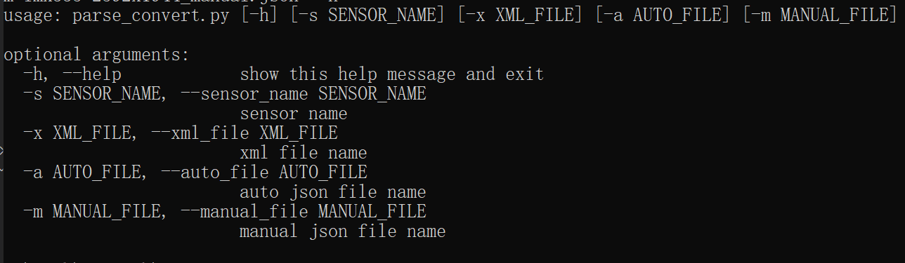

Execute the conversion header file tool parse_convert.py, parse and convert the three copied configuration files into a parameter header file (it is recommended to use python3.x for the conversion tool)
#include "isp_database.h"
#include "k_autoconf_comm.h"
/* calib data */
/* auto data */
/* manual data */
/* dewarp data */
/* version_info */
#endif
After conversion, a structure similar to the above will be obtained, consisting of five parts:
calib data, auto data, manual data are generated by parsing the specified external configuration files
dewarp data needs to be replaced in the structure according to actual configuration, refer to dewarp parameter configuration
version info is automatically generated by the conversion tool, describing the sensor name and creation date

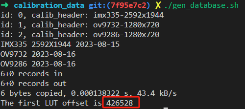

has_lut: Indicates whether there is a dewarp LUT file. Setting this member to 0 means that dewarp parameters are not needed. Setting it to 1 means that dewarp parameters are needed.
lut_offset: When has_lut is set to 1, this member is effective. The value corresponds to the offset of the dewarp parameter in the parameter partition. The specific calculation method is parameter partition base address + header size + parameter structure size + padding size. The parameter partition base address is defined as CONFIG_MEM_SENSOR_CFG_BASE in k_autoconf_comm.h. This definition varies with different compiled hardware. It can be calculated by the gen_database.sh script provided by the SDK. The execution will print the result:
Figure 2-2 Parameter Partition Automatically Calculates Dewarp Offset
split_enable: Default set to 0
split_horizon_line: Default 8191
split_vertical_line_up: Default 8191
split_vertical_line_down: Default 8191
The dewarp parameter file needs to specify the path in the production script, refer to the subsequent sections

2.2.2.6 Scripted Production of Binary Files#
The SDK provides a semi-automated script gen_database.sh that links processes 2.2.2.1 - 2.2.2.5. After completing the source code definitions for header, dewarp, and parameter parsing, users can execute this script to produce the binary file, or even compile the SDK directly without manually executing the script.
#!/bin/sh
DATABASE_CURRENT_DIR=$PWD
-I$DATABASE_CURRENT_DIR/../../t_common_c/include/ \
-I$DATABASE_CURRENT_DIR/../../t_json_c/include/ \
DATABASE_SELECT 0: imx335 2592x1944, 1: ov9732 1280x720, 2: ov9286 1280x720, ...
echo -n
sensor_cfg_02.bin\
padding.bin\
