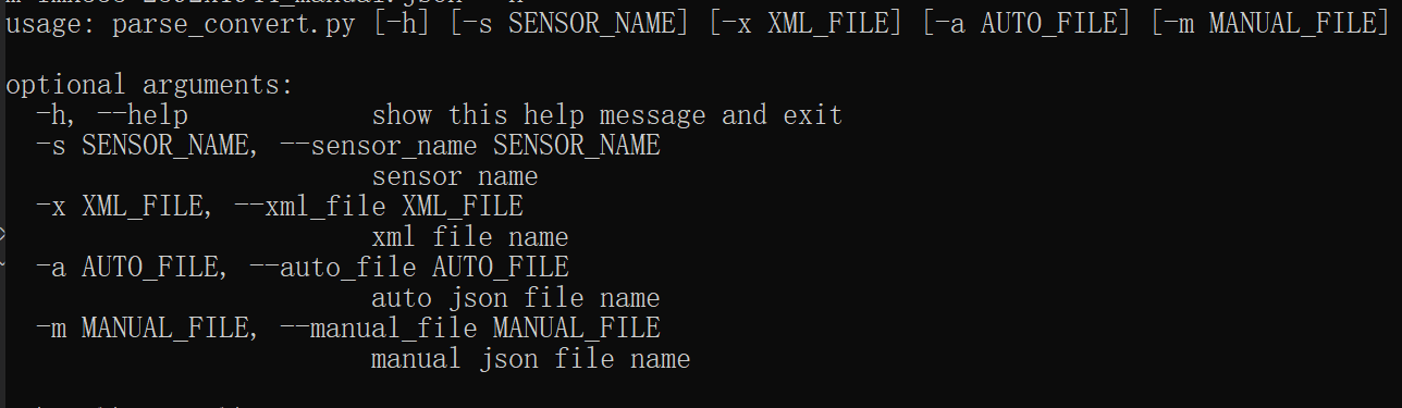

Execute the Convert Header File Tool parse_convert.py to parse and convert the copied three configuration files into a single parameter header file (Python 3.x is recommended by the conversion tool).
parse_convert

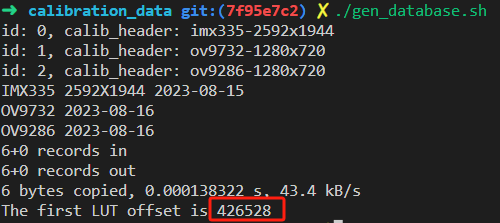

lut_offset: When the has_lut is set to 1, the member takes effect, and the value will correspond to the offset of the address of the dewarp parameter in the parameter partition, the specific calculation method is parameter partition base address + header size + parameter structure size + padding size , and the parameter partition base address is defined in k_autoconf_comm.h CONFIG_MEM_SENSOR_CFG_BASE, this definition varies depending on the hardware on which it is compiled. It can be calculated through gen_database.sh script provided by the SDK and printed when executed:
calc_isp_param_data_size
Figure 2-2 The parameter partition automatically calculates the dewarp offset

    CONFIG_MEM_SENSOR_CFG_BASE + 426528, // 426528: calc from the script

Scripting binary files#
The SDK provides semi-automated scripts for the concatenation process 2.2.2.1 - 2.2.2.5 named gen_database.sh, and users can directly compile the SDK by executing the source code definition of header, dewarp, and parameter parsing after completing the source code definition of header, dewarp, and parameter parsing.
