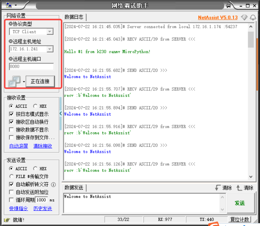

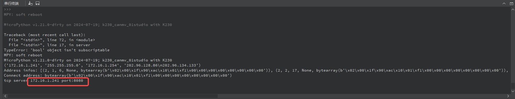

Running and verification#
  1. Run the script and note the IP and 8080 port output on the serial port.
  2. Connect to this address in a computer TCP client.
  3. Confirm that the computer receives the welcome message, then send text.
  4. The serial port should print the received bytes, and the computer side should receive the echo with the recv : prefix.
  5. Send end to end the current connection.
