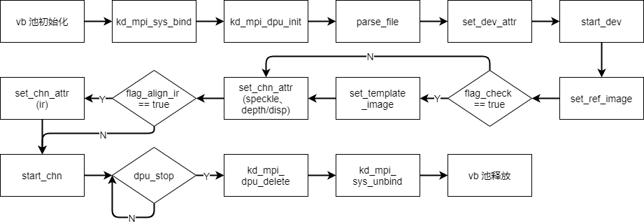

1.2.1 Binding Mode Call Process#

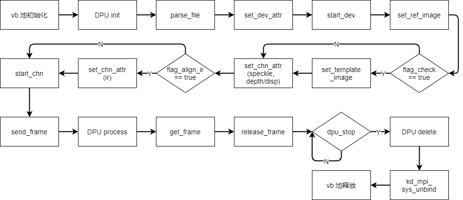

1.2.2 Non-Binding Mode Call Process#

6.2.1 Non-binding Mode#
By calling the API, the DPU device is initialized, parameters are parsed from the configuration file, device attributes are configured based on the parsed parameters, the API is called to set the reference image and template image, the DPU device is started, speckle and infrared image channel attributes are configured, the channel is started, ten frames are looped through and the results are compared, then the channel is stopped, the device is stopped, and the device is deleted.
6.2.2 Binding Mode#
By calling the API, the DPU device is initialized, parameters are parsed from the configuration file, VVI and DPU channels are bound, device attributes are configured based on the parsed parameters, the API is called to set the reference image and template image, the DPU device is started, speckle and infrared image channel attributes are configured, the DPU channel is started, the VVI channel is started, and VVI continuously inputs data to the DPU as the simulated upper layer. The user inputs ‘e’ to stop the channel and device.
