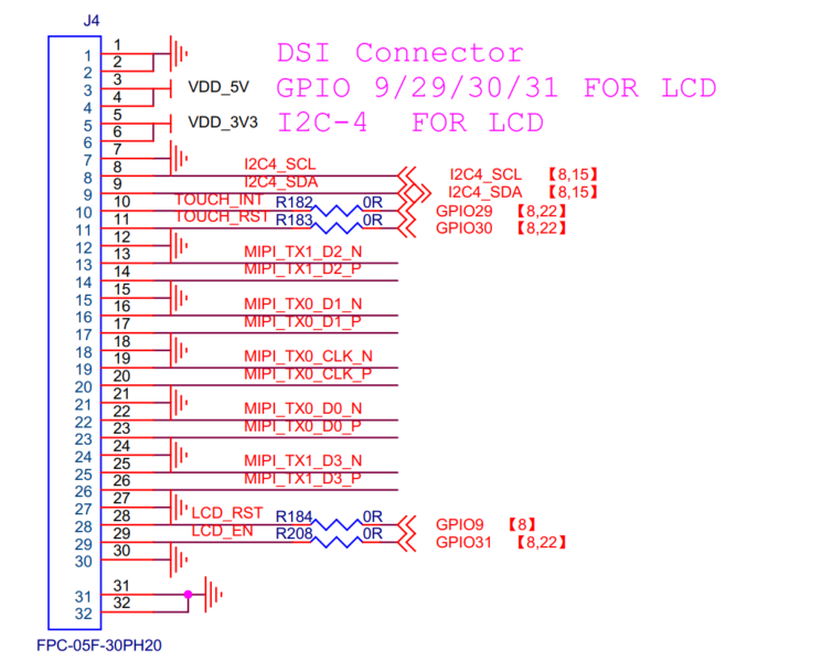

1.1.1 Mipi Interface#
The hardware pins on the evblp3 are as follows:
Screen touch IIC uses iic4 (scl: gpio7, sda gpio8)
Screen touch rst: gpio29, int: gpio30
Screen rst: gpio9, backlight: gpio31
Mipi pins correspond one-to-one with the screen pins

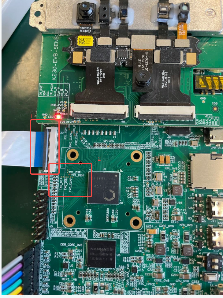

1.1.2 Physical Diagram#
In the figure, 1 is the mipi interface, using a soft ribbon cable
In the figure, 2 is the mipi signal test point, containing four data lines and one clk line

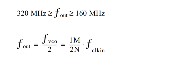

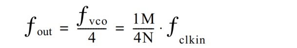

The phy frequency requires three parameters to be configured: calculate PLL, configure voc, and configure freq. Based on these three parameters, the txphy frequency can be determined. Each parameter calculation is as follows.

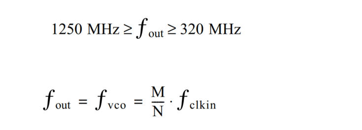

1.2.1.1 Calculate the PHY PLL#
The data rate is given by twice the PLL output clock phase frequency: Data rate (Gbps) = PLL Fout (GHz) * 2. The output frequency is a function of the input reference frequency and the multiplication/division ratio. The calculation of the phy PLL is divided into 4 ranges, each corresponding to a different frequency. It can be determined as follows:
M |
m+2 |
N |
n+1 |
Fclkin |
24M |
For:

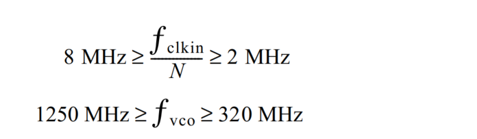

However, the following restrictions must be followed:
For:
For:
For:
Each of the above corresponds to a pll level, with different levels corresponding to different calculation formulas and restrictions. An example calculation is as follows:

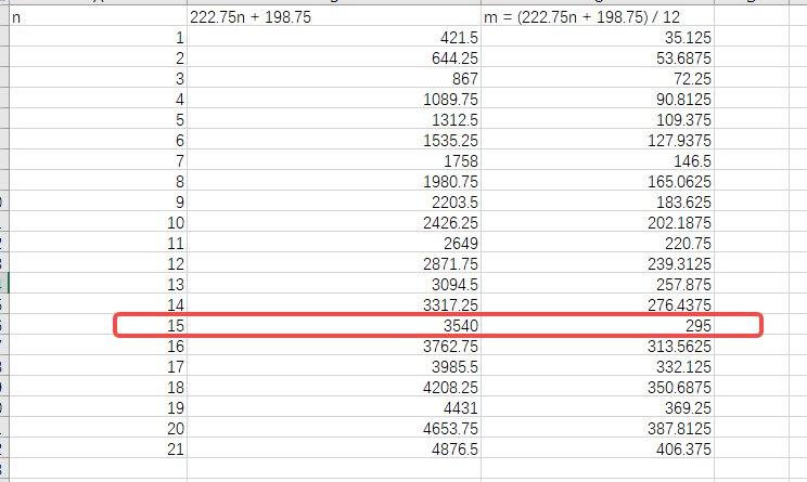

Example:
The mipi rate is 445.5M, so the pll rate is 222.75M. The second formula should be chosen, and the calculation is as follows:
222750000 = 1M / 2N = (m+2) / 2(n+1) * 24000000. The formula is rearranged as follows:
222.75n + 198.75 = 12m. The calculation using Excel is as follows:
The resulting m = 295, n = 15.
The configuration of m and n in the pll must be integer values. If none of the values are integers, m and n need to be adjusted by adding or subtracting 1, then recalculating to find the closest frequency, and verifying if it’s usable. If not, repeat the above steps.

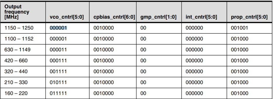

1.2.1.2 Configure the PHY VOC#
The configuration of the phy voc can be determined by referring to the table:
Example:
The mipi rate is 445.5M, so the pll rate is 222.75M, voc = 010111 = 0x17.

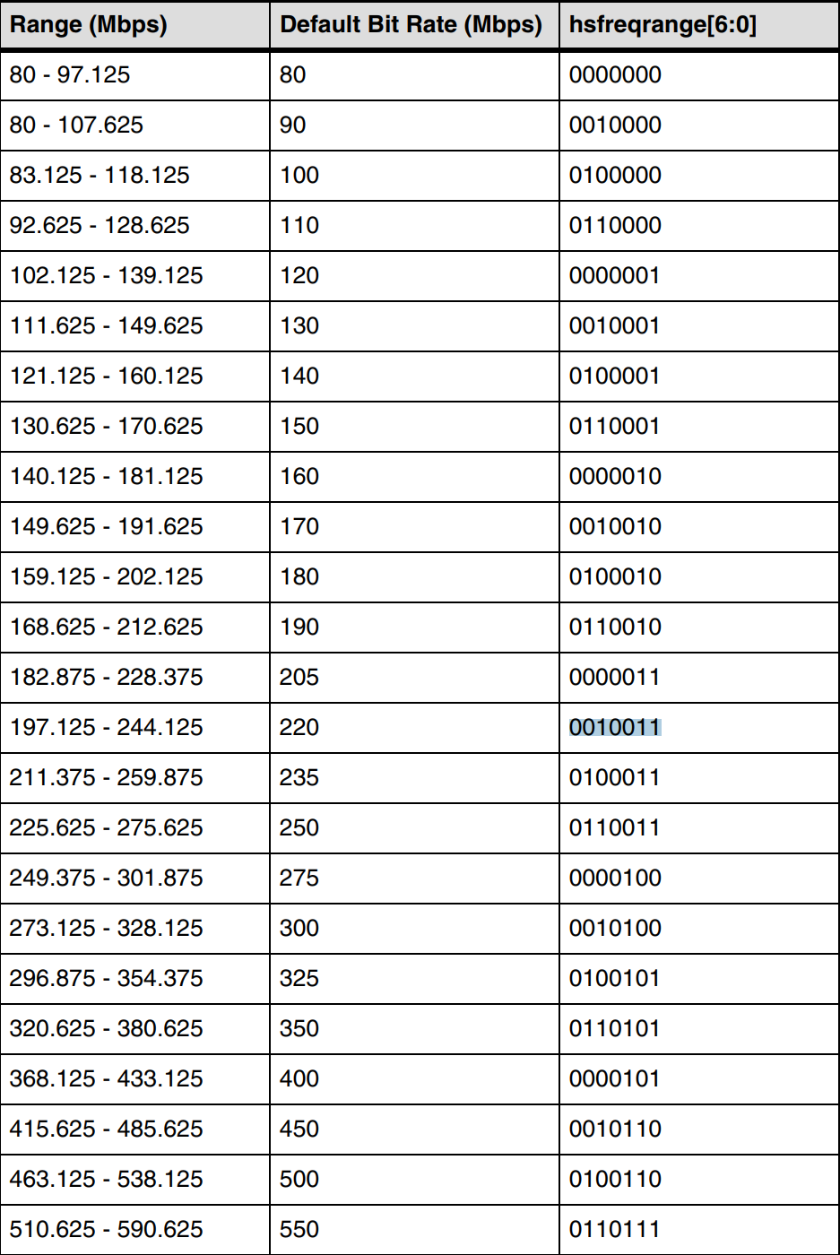

1.2.1.3 Configure the Frequency#
The configuration of the phy frequency can be determined by referring to the table:
Example:
The mipi rate is 445.5M, so the pll rate is 222.75M. The frequency is chosen as 0100101. When configuring this, the highest bit bit[7] = 1, so freq = 10100101= 0xa5.

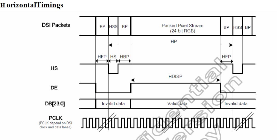

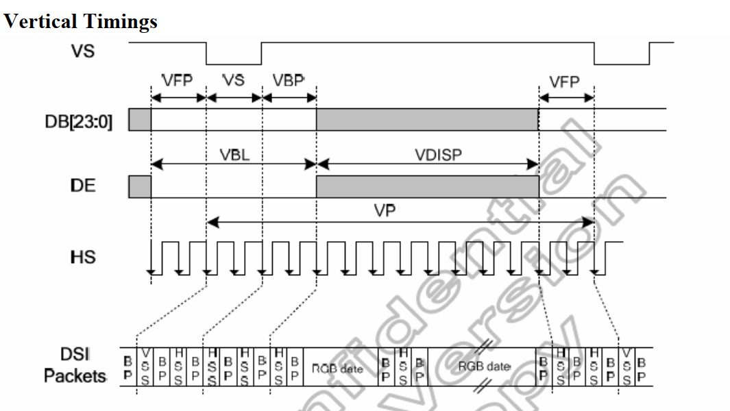

1.2.2.1 Configuring Display Timing#
Each manufacturer’s screen has a set of timings used for screen control, mainly including frame control timing and line control timing, as shown in the following figure:
The timing used in DSI is consistent with the screen’s timing configuration.

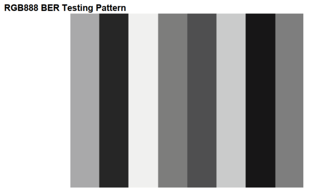

1.2.2.3 DSI Self-Test Mode#
The DSI self-test mode generates color bar data according to the configured DSI timing and sends it out, thus not relying on the VO to read data from DDR. The test mode display is as follows:
The DSI and VO use a 24-bit interface, so the configured color bar appears as shown above. The usage method is to enable the color bar after configuring the DSI. The API is as follows:
