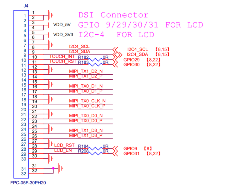

MIPI interface#
The hardware pins on EVBLP3 are as follows:
The image contains an illustrated description that has been automatically generated
  • screen touch is I2C4 (SCL: GPIO7, SDA GPIO8)
  • screen touch rst:gpio29, int:gpio30
  • screen rst:gpio9,backlight:gpio31
  • The pins of MIPI correspond one-to-one with the pins of the screen

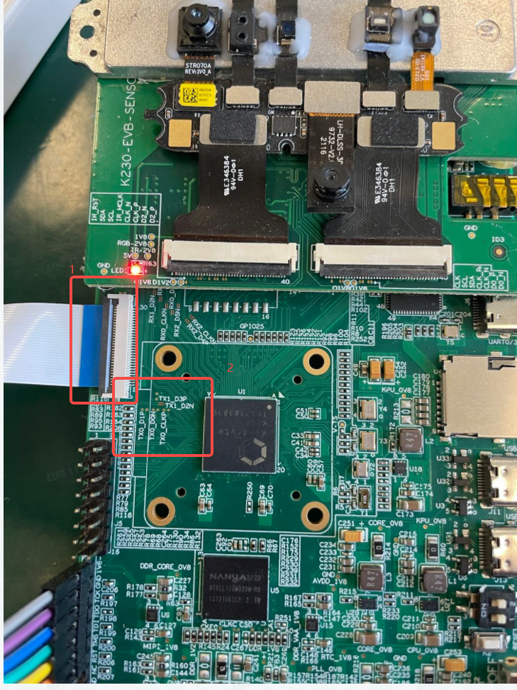

Physical drawings#
Image contains game console, electronics, circuit description has been automatically generated
  • Figure 1 is the MIPI interface, using a flexible cable
  • Figure 2 is the MIPI signal test point, including four data lines and one CLK line

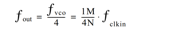

Calculate the PLL of PHY#
The data rate is given by twice the PLL output clock phase frequency: data rate (Gbps) = PLL Fout(GHz) * 2, and the output frequency is a function of the input reference frequency and the multiplier/divider ratio. The PLL for calculating PHY is divided into 4 ranges to do calculations, different frequencies correspond to different frequencies, which can be determined in the following ways:
M
m+2
N
n+1
Fclkin
24M
For:
Text, letter description is automatically generated
However in this need to follow the following restrictions:
The image contains a text description that has been automatically generated
For:
For:
The Text description is automatically generated
For:
The text Medium confidence description has been automatically generated
Each of the above for corresponds to a PLL level, and different levels correspond to different calculation formulas and limits, and the calculation example is as follows:

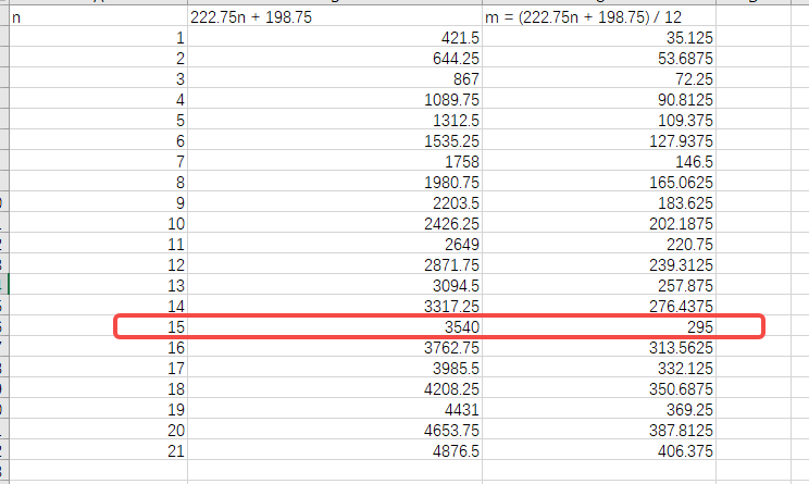

Example:
The rate of mipi is 445.5M: so the rate of pll is 222.75M, and the second formula should be selected, calculated as follows
222750000 = 1M / 2N = (m+2) / 2(n+1) * 24000000 , the finishing formula is as follows:
222.75n + 198.75 = 12m is calculated by excel as follows:
The table description is automatically generated
The resulting m = 295 and n = 15.
Configure the m and n in the PLL are integer values, if all the values are not integers, you need to add 1 and subtract 1 from the values of m and n, push back to see which frequency you need to be the closest, and then verify whether it is available, you can’t repeat the above operation.

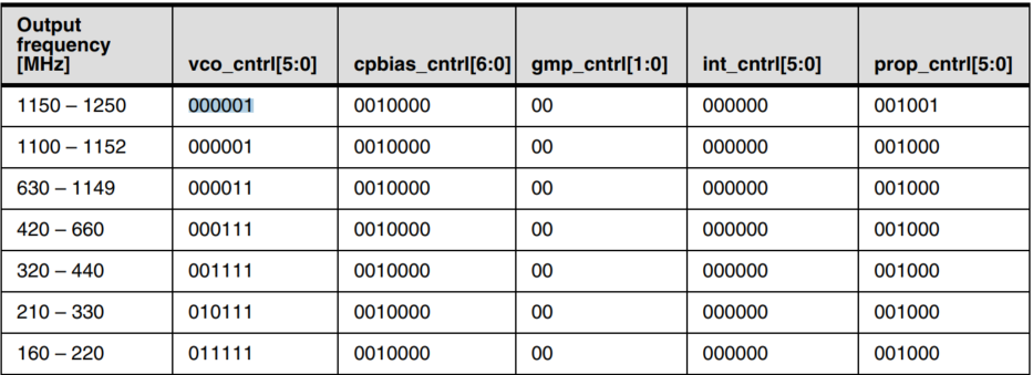

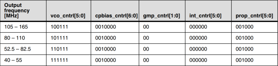

Configure VOC for PHY#
The VOC configured with PHY can be queried according to the table:
Example:
The rate of mipi is 445.5M: so the rate of the pll is 222.75M, and VOC = 010111 = 0x17

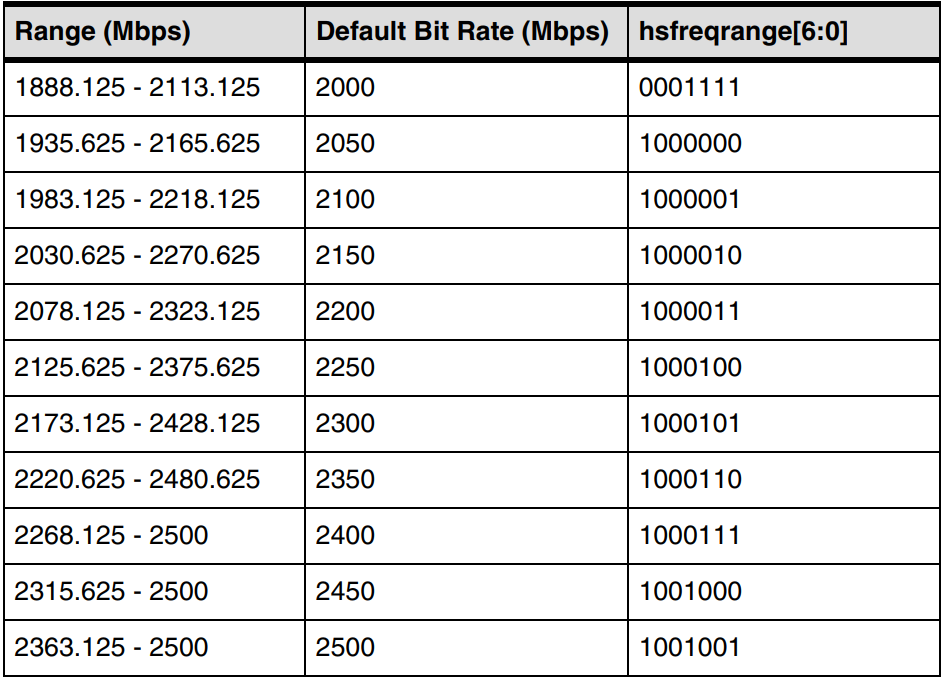

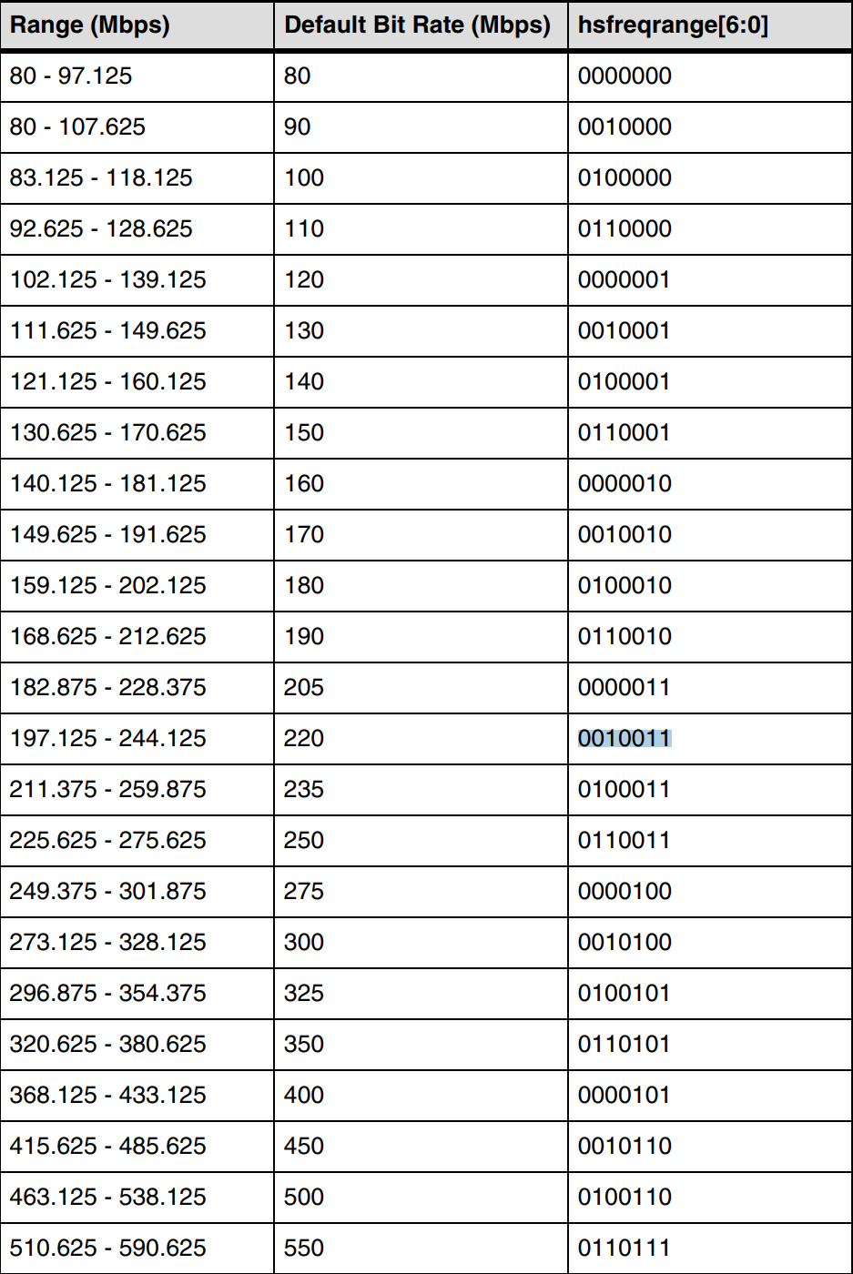

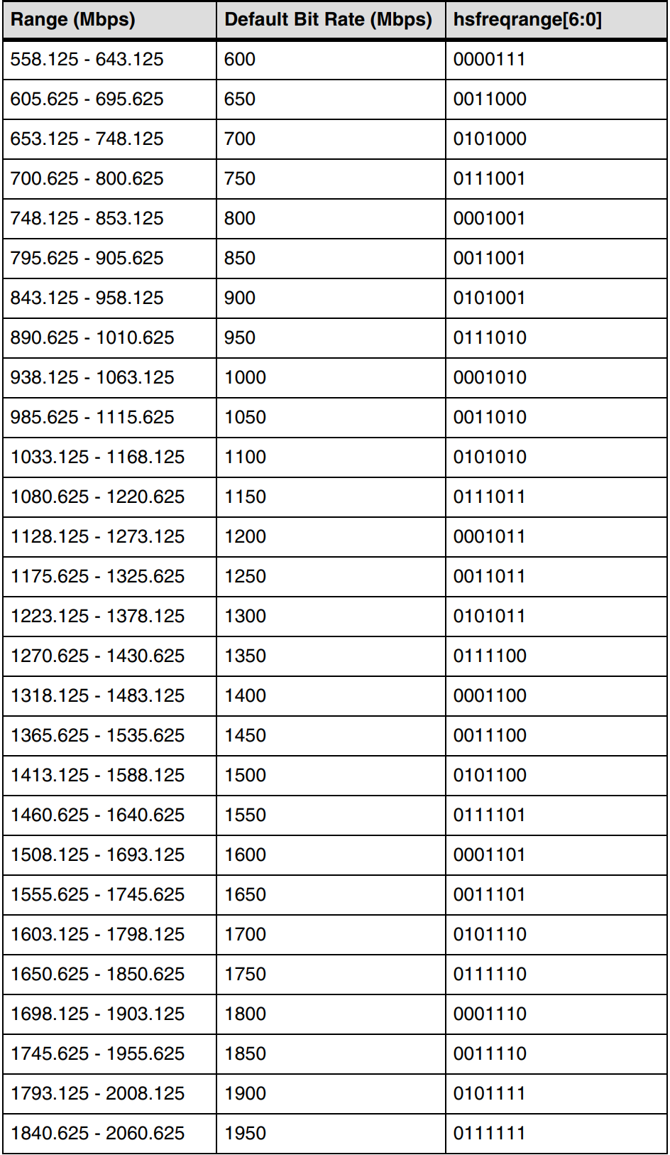

Configure FreQ#
The FREQ of the configured PHY can be queried according to the table:
Example:
The rate of mipi is 445.5M: the rate of pll is 222.75M, freq selects 0100101, when configuring this, you need to set the highest bit [7] = 1, all freq = 10100101 = 0xa5

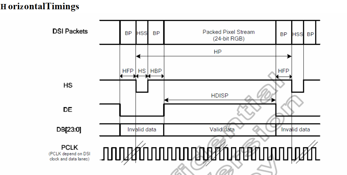

Configure the timing of the display#
Each manufacturer’s screen will have a set of timing for screen control, mainly including the control timing of the frame and the control timing of a line, as shown in the following figure:
The Illustrative description has been automatically generated
Illustrative, Schematic description is automatically generated
These parameters are also used in DSI, and the configured timing and screen are consistent.

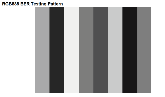

DSI’s self-test mode#
The DSI self-test mode will send the data of the color bar according to the self-configured DSI timing to be sent, so that it does not rely on VO to read data from the DDR, and the test mode is shown as follows:
Background pattern The medium confidence description has been automatically generated
The 24-bit interface is used between DSI and vo, so the configured color bar is the effect shown above, and the use method only needs to enable the color bar after configuring DSI, and the API is as follows
