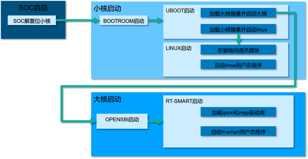

The overall boot process of K230 is shown in the following diagram:
K230 Overall Boot Process Diagram

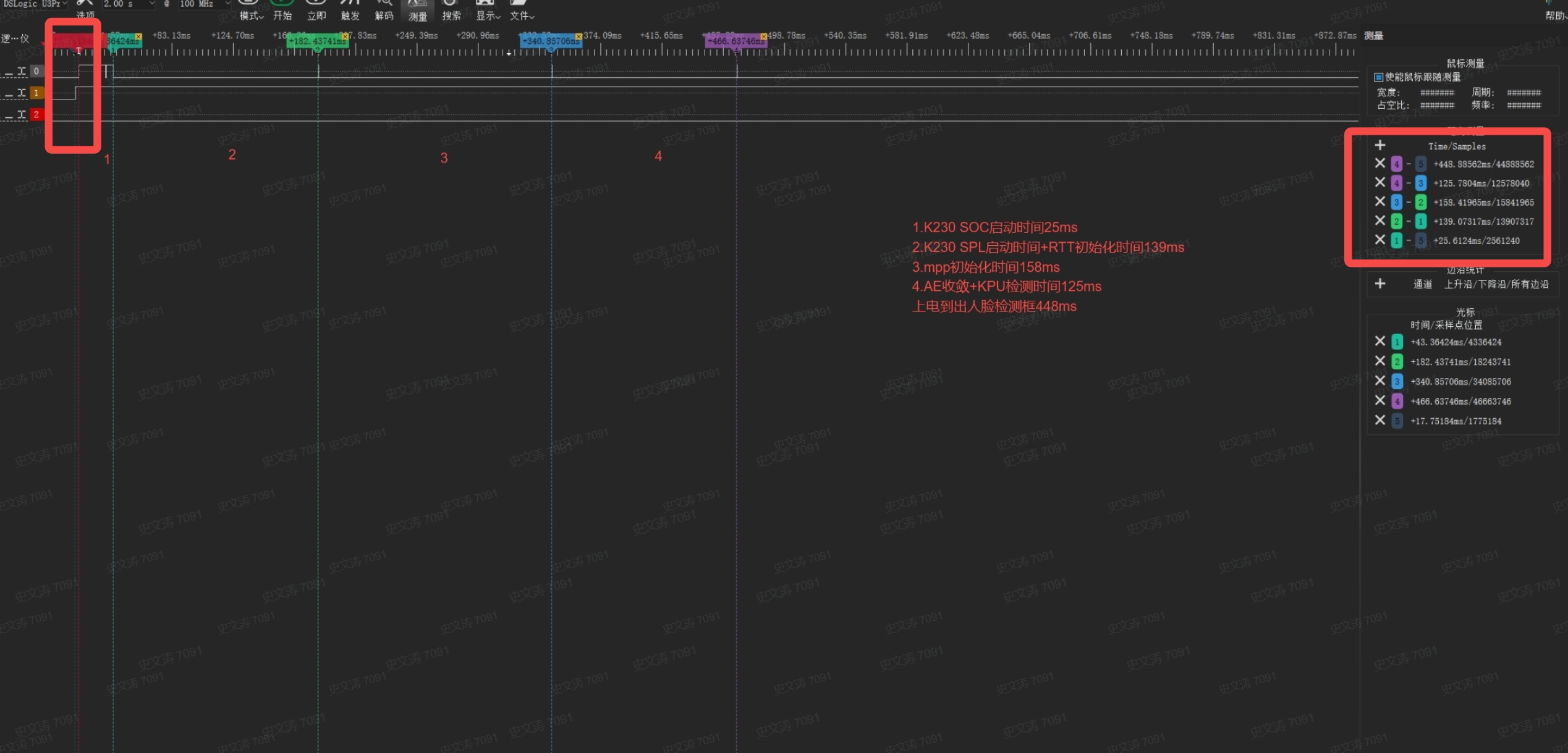

Hardware Measurement#
Add GPIO edge changes at the points that need to be measured. More accurate time can be obtained through a logic analyzer or oscilloscope. You can detect the power-on signal of the development board through pin 14 of J1 on the K230_EVB_LPDDR3_UNSIP board (you need to short-circuit pins 15 and 16 with a jumper cap). Logic Analyzer Statistics Boot Time

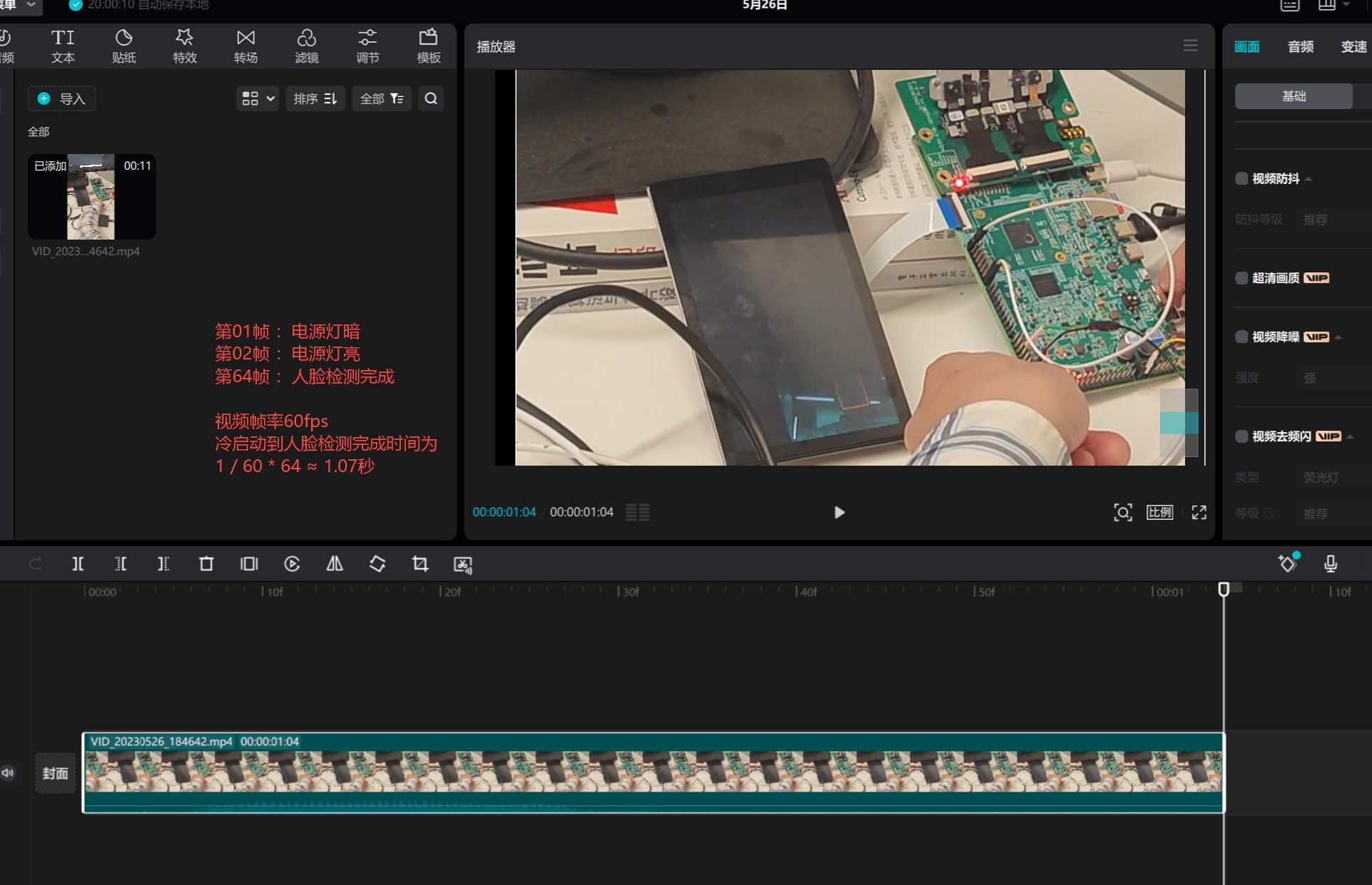

External Observation#
Record the entire system boot process via video. The onboard power light turning on represents the system powering up, and the VO displaying the VI image indicates that the video pipeline is established and can be displayed. A frame appearing around a face indicates that face recognition is completed. Editing Software Analysis Boot Time

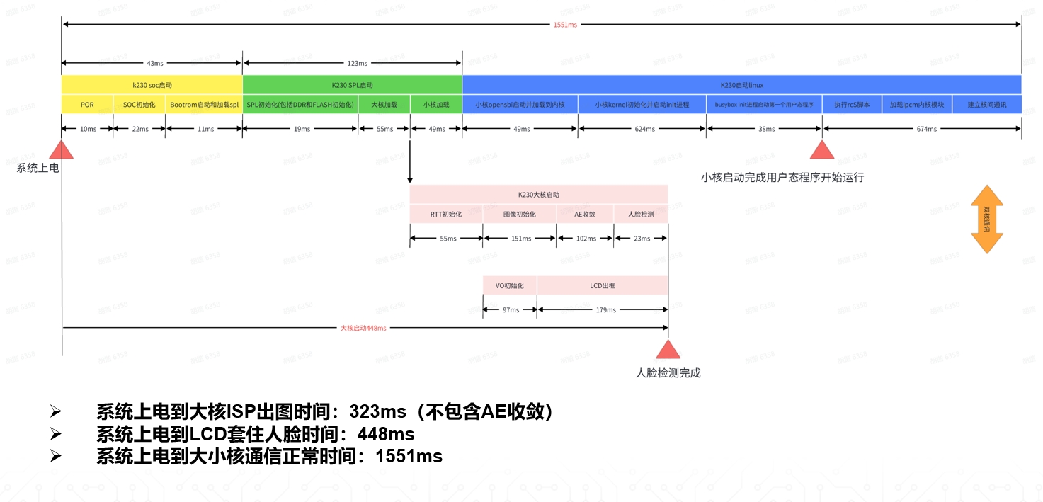

Optimization Effects#
The boot time statistics of the door lock POC. This statistical data was measured on June 9th, and there may be discrepancies with the current latest SDK version data. Door Lock POC Boot Time
