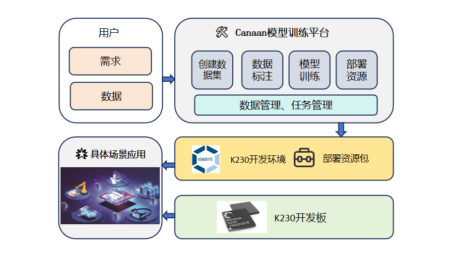

Introduction to the cloud training platform#
The Canaan developer community model training function is an open training platform to simplify the development process and improve development efficiency. The platform allows users to pay attention to the implementation of visual scenes, and complete the process from data annotation to obtaining the KModel model in the deployment package more quickly, and deploy it on the K230 and K230D chip development boards equipped with Canaan Technology Kendryte® series AIoT chips. Users only need to upload the data set and simply configure the parameters to start training.
📌Platform address:Canaan Cloud Training Platform
📌Platform usage documentation reference:Canaan Cloud Training Platform Document Tutorial, please pay attention to the format of the dataset!
Support task introduction#
There are 7 visual tasks supported by the K230 series chips in the cloud training platform, and the task introduction is as follows:

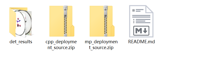

After training, you can download the deployment package corresponding to the training task. After the downloaded deployment zip package is decompressed, the directory is as follows:
📦 task_name
├── 📁 **_result
├── cpp_deployment_source.zip
├── mp_deployment_source.zip
└── README.md
The content is shown in the picture:
in mp_deployment_source.zip that is, the code package deployed on the K230 MicroPython image, which internally contains the deployed configuration files and the deployed KModel model.
