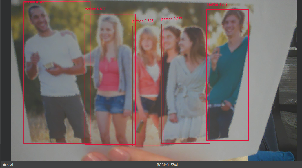

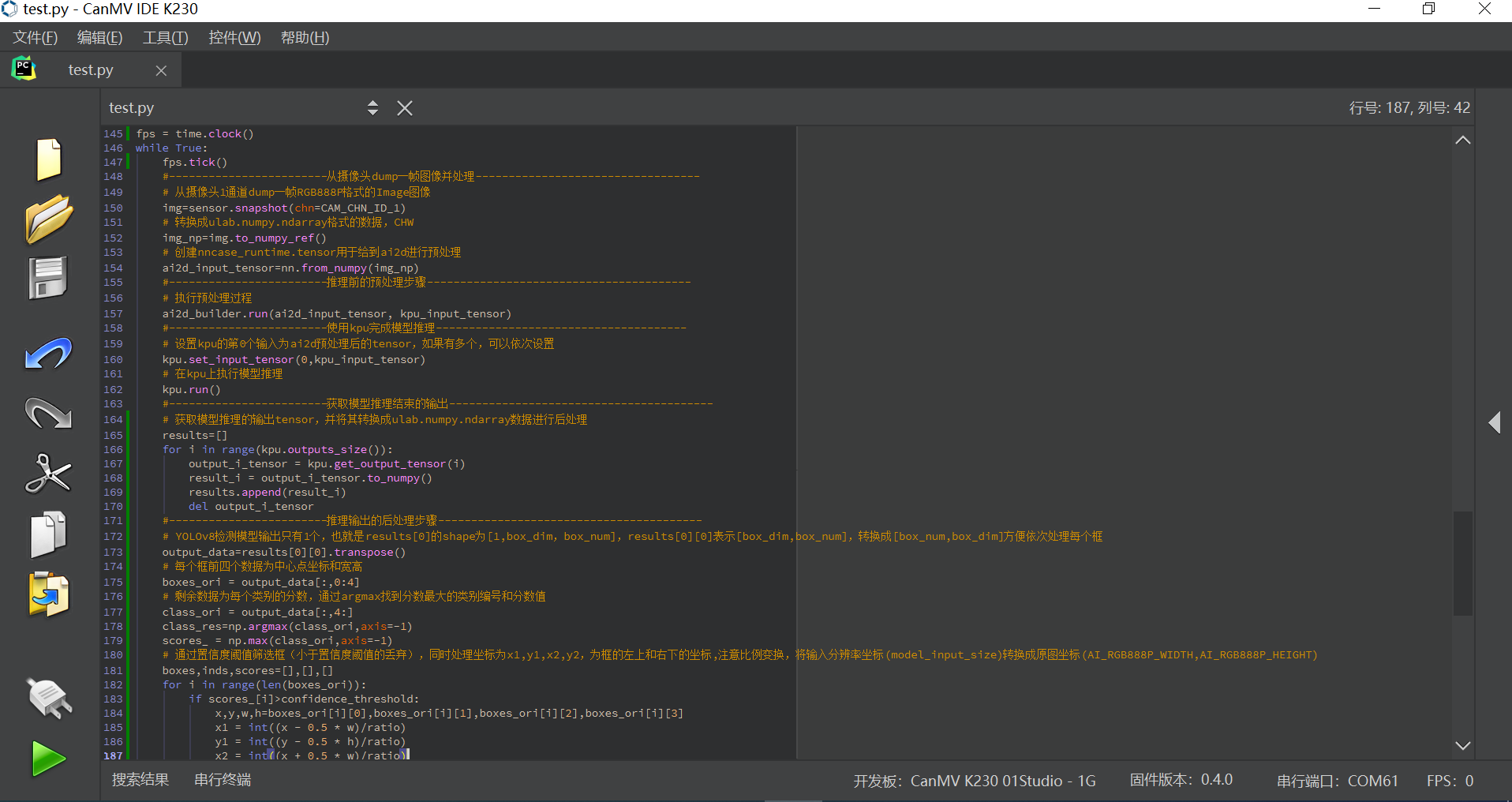

Run the sample code#
pass CanMV IDE K230 open the sample program code and click the Run button to start running the YOLOv8 detection sample program. For the use of IDE, please refer to:How to use IDE
Open the sample program through the IDE and run it as shown in the following figure:
The operation results are shown in the figure below:
