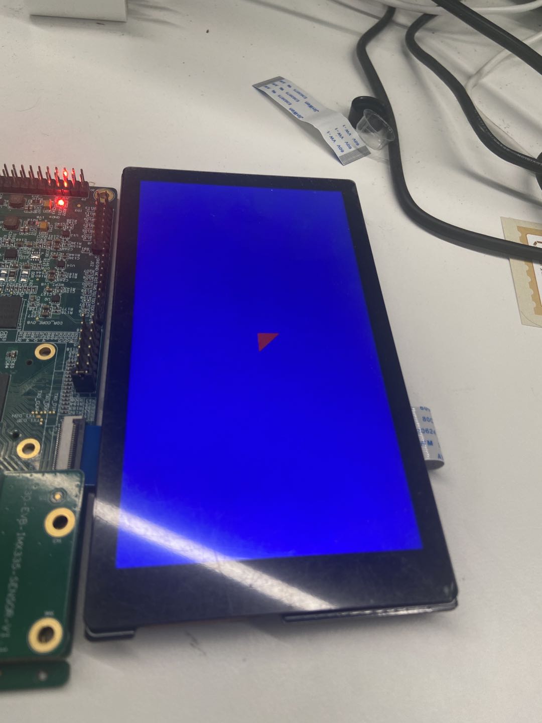

The complete reference code can be viewed in vglite_drm, and below is the plotted effect.
A simple triangle to draw
It is easy to see that the coordinate system is right in the positive x direction and the following is the positive direction of y, which is also the coordinate system used by SVG.
