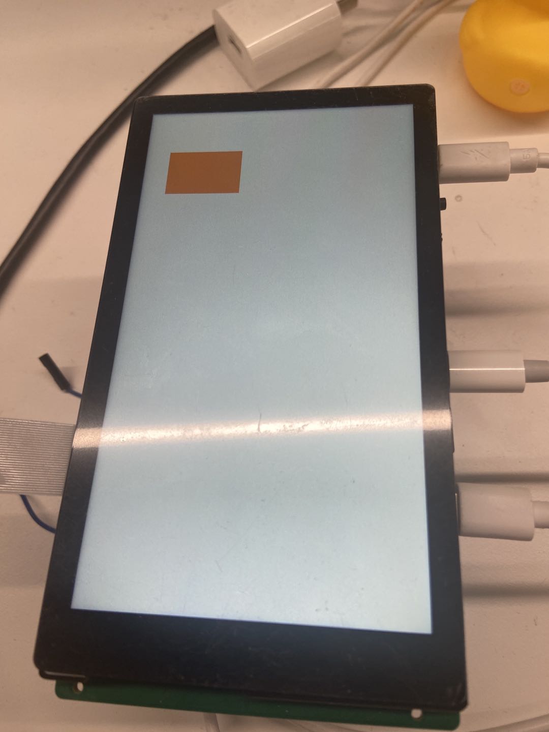

The K230 EVB has a 1080x1920 display. On the small-core Linux, DRM can be used for display. Letting the GPU driver load the DRM dumb buffer can reduce memory copying and achieve efficient rendering. The GPU+DRM related code can be referred to in the vglite_drm demo. Readers can add drm.c to their programs.
Note that as of K230 SDK v0.8, the DRM driver on Linux cannot work independently and relies on the configuration of the SoC video output module by the large core. This can be done by executing sample_vo.elf 3 on the large core.
Additionally, the color format enumeration of DRM does not completely match vg_lite_buffer_format_t. For example, VGLITE_BGRA8888 represents a 32-bit color with red in the lowest 8 bits and alpha in the highest 8 bits, corresponding to DRM_FORMAT_ARGB8888 in DRM.
The image above shows the correct color displayed on the screen after running the vglite_drm demo: R(255)G(128)B(16).

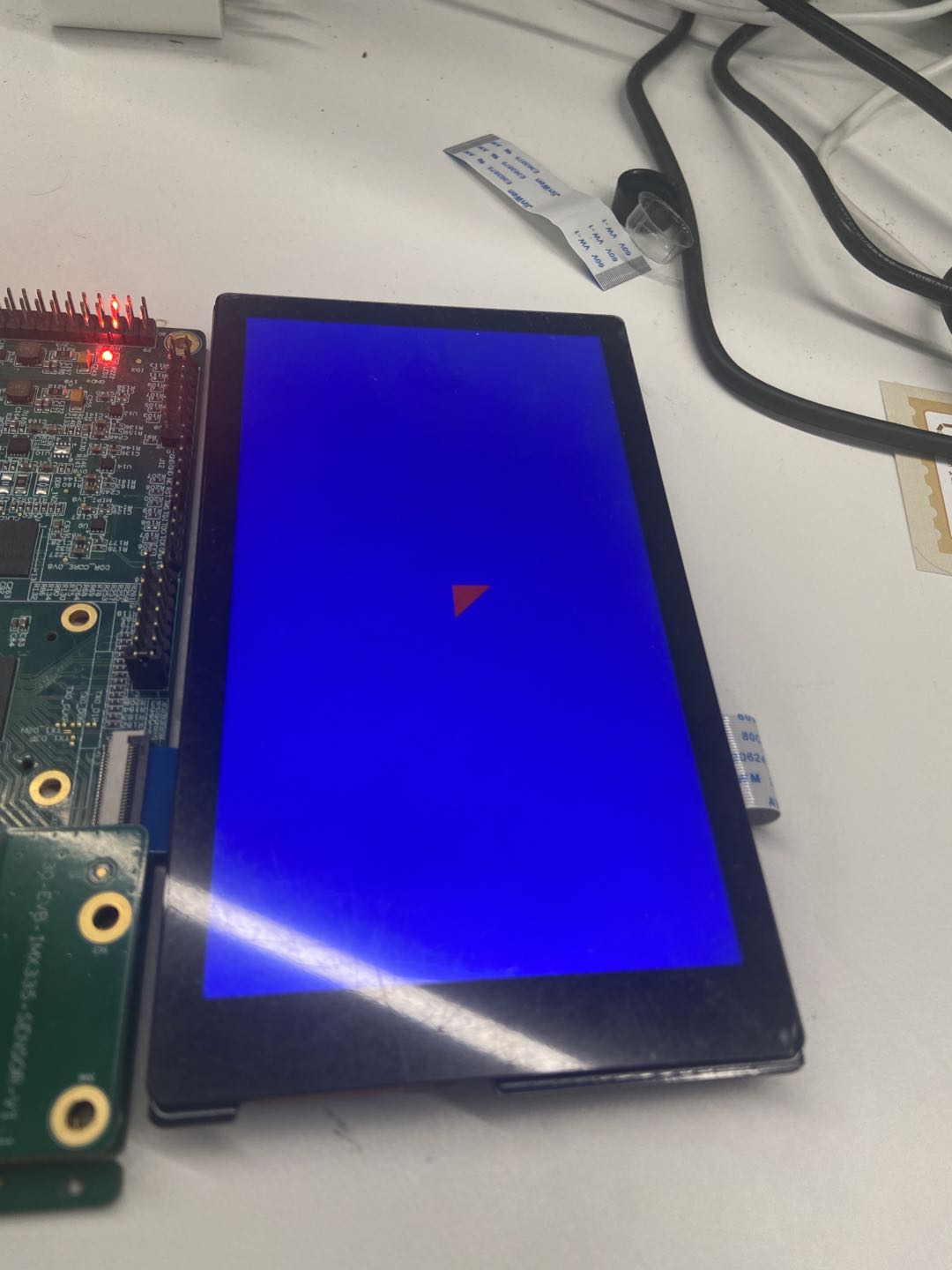

The complete reference code can be found in vglite_drm, and the result of the drawing is shown below.
It is easy to see that the coordinate system has the positive x direction to the right and the positive y direction downward, which is also the coordinate system used by SVG.
It should be noted that when I mentioned “rendering” with vg_lite_draw, it was in quotes because it doesn’t actually render; it just writes the rendering commands. The final rendering requires calling vg_lite_finish, which is beneficial for performance. In practical use, you can call vg_lite_draw multiple times and then execute vg_lite_finish just before the actual display, since vg_lite_finish is a system call with some overhead, while vg_lite_draw is not and can be executed very quickly.
After rendering is complete, you can display the result on the screen or save it as an image. Note that when saving an image, the CPU reads the data, so you need to ensure that vg_lite_buffer_t::memory is readable. If you use the DRM code above to create vg_lite_buffer_t, you won’t be able to read it if the DRM dumb is not mapped.

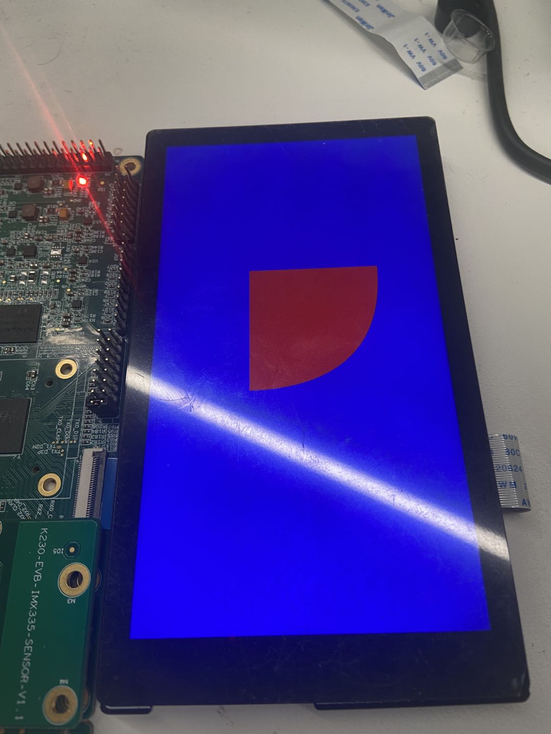

Of course, elliptical arcs can be approximated using cubic Bézier curves, essentially making them the same type of curve. Similar to drawing polygons, you only need to modify the opcodes and data.
Let’s try changing the bottom edge of the previously drawn triangle to a quadratic Bézier curve, with the midpoint at (1,1), to draw a shape resembling a rounded corner. Modify the path_data as follows:
uint8_t path_data[] = {
2, 0, 0,
4, 0, 1,
6, 1, 1, 1, 0, // Quadratic Bézier curve, control point (1,1), draw to (1,0)
4, 0, 0,
To better observe this curve, increase the scaling factor, say to 500 times, and adjust the translation to approximately center the shape on the screen.
The final drawn shape looks like this:
