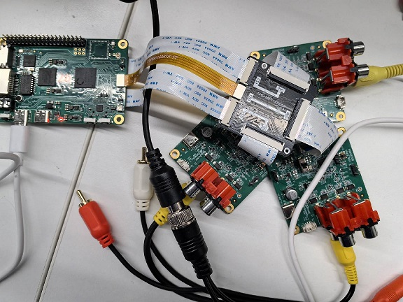

2.6 Vicap_demo#
2.6.1 Vicap_demo Introduction#
The vicap demo implements camera data collection and preview functions by calling MPI interfaces.
2.6.2 Feature Description#
The CanMV development board uses the OV5647 camera module by default, supporting up to three data streams from a single camera.
2.6.3 Dependency Resources#
Camera module
2.6.4 Usage Instructions#
2.6.4.1 Compilation#
Execute
make mpp-clean && rt-smart && make build-imagein the k230_sdk directory to compile the modifications for the large core into the SD card image. The image filesysimage-sdcard.imgwill be generated in thek230_sdk/output/k230_evb_defconfig/images/directory.
2.6.4.2 Execution#
Copy the
src/big/mpp/userapps/sample/elf/sample_vicap.elffile to a specified local directory.Mount this directory to
/sharefson the small core Linux via NFS.On the large core, use the
cd /sharefscommand to enter the/sharefsdirectory.Execute the
./sample_vicapcommand in this directory to get command help information.
When you input the sample_vicap command, the following prompt information will be printed:
usage: ./sample_vicap -mode 0 -dev 0 -sensor 23 -chn 0 -chn 1 -ow 640 -oh 480 -preview 1 -rotation 1 // Canmv-K230-V1.0/1.1 board
usage: ./sample_vicap -mode 0 -dev 0 -sensor 33 -chn 0 -chn 1 -ow 640 -oh 480 -preview 1 -rotation 1 // Canmv-K230-V2.0 board
Options:
-rotation: display rotaion[0: degree 0, 1: degree 90, 2: degree 270, 3: degree 180, 4: unsupport rotaion, 17: gdma-degree 90, 18: gdma-degree 180, 19: gdma-degree 270]
-help: print this help
Parameter Name |
Optional Values |
Parameter Description |
-dev |
0: vicap device 0, 1: vicap device 1, 2: vicap device 2 |
Specify the current vicap device in use. The system supports up to three vicap devices. By specifying the device number, the sensor can be bound to different vicap devices. For example: |
-mode |
0: online mode; 1: offline mode |
Specify the vicap device working mode. Currently, both online and offline modes are supported. For multiple sensor inputs, offline mode must be specified. |
-conn |
0: Screen hx8399; 1: HDMI lt9611-1920x1080p60; 2: HDMI lt9611-1920x1080p30 |
Specify the display method, you can choose between screen or HDMI. The default is 0. |
-sensor |
23: OV5647 (Canmv-K230-V1.0/1.1 board), 33: OV5647 (Canmv-K230-V2.0 board) |
Specify the current sensor type in use. |
-chn |
0: vicap device output channel 0, 1: vicap device output channel 1, 2: vicap device output channel 2 |
Specify the current output channel of the vicap device. A vicap device supports up to three outputs, with only channel 0 supporting RAW image format output. |
-ow |
Specify the output image width, default is the input image width. The width needs to be 16-byte aligned. If the default width exceeds the maximum output width of the display screen, the display output width will be used as the final output width. If the output width is less than the input image width and the |
-oh |
Specify the output image height, default is the input image height. If the default height exceeds the maximum output height of the display screen, the display output height will be used as the final output height. If the output height is less than the input image height and the |
-ox |
Specify the horizontal starting position of the image output. If this parameter is greater than 0, output cropping will be performed. |
-oy |
Specify the vertical starting position of the image output. If this parameter is greater than 0, output cropping will be performed. |
-crop |
0: disable cropping function, 1: enable cropping function |
When the output image size is smaller than the input image size, it defaults to scaled output. If this flag is specified, it will crop the output. |
-ofmt |
0: yuv format output, 1: rgb format output, 2: raw format output |
Specify the output image format, default is yuv output. |
-preview |
0: disable preview display, 1: enable preview display |
Specify the output image preview display function. Default is enabled. Currently, up to 2 output images can be previewed simultaneously. |
-rotation |
0: rotate 0 degrees, 1: rotate 90 degrees, 2: rotate 180 degrees, 3: rotate 270 degrees, 4: unsupported rotation, 17 use gdma rotate 90 degrees, 18 use gdma rotate 180 degrees, 19 use gdma rotate 270 degrees |
Specify the rotation angle of the preview display window. only the first output image window supports the vo rotation function, all output image window supports gdma rotation function. |
Example 1:
./sample_vicap -conn 1 -dev 0 -sensor 23 -chn 0 -chn 1 -ow 640 -oh 480 -preview 0 // Canmv-K230-V1.0/1.1 board
./sample_vicap -conn 1 -dev 0 -sensor 33 -chn 0 -chn 1 -ow 640 -oh 480 -preview 0 // Canmv-K230-V2.0 board
Description: Bind the OV5647@1920x1080 RGB output to vicap device 0, and enable vicap device output channels 0 and 1. Channel 0 output size defaults to the input image size (1920x1080), and channel 1 output image size is 640x480.
Example 2: OV5647 Triple Camera
Note: The two OV5647s on the back can use the Raspberry Pi OV5647 camera. The Canmv-K230 V1.0 V1.1 version of the board needs to replace the LDO to 1.8V, such as RT9013-18. As shown below:
If it is inconvenient to replace the LDO, you can wait for the subsequent V1.2 version of the board.
./sample_vicap.elf -conn 1 -mode 1 -dev 0 -sensor 23 -chn 0 -ow 320 -oh 240 -dev 1 -sensor 26 -chn 0 -ow 320 -oh 240 -dev 2 -sensor 27 -chn 0 -ow 320 -oh 240 -ofmt 1 // Canmv-K230-V1.0/1.1 board
./sample_vicap.elf -conn 1 -mode 1 -dev 0 -sensor 31 -chn 0 -ow 320 -oh 240 -dev 1 -sensor 32 -chn 0 -ow 320 -oh 240 -dev 2 -sensor 33 -chn 0 -ow 320 -oh 240 -ofmt 1 // Canmv-K230-V2.0 board

2.16 YUV Sensor Demo#
2.16.1 Demo Introduction#
Three-way YUV sensor input, outputting YUV444 packed format to DDR through VICAP’s MCM hardware, and converting to NV12 format using the CSC function of nonai_2d hardware.
VICAP binds to nonai_2d, nonai_2d outputs to both VENC and VO, performing RTSP streaming and screen display.
2.16.2 Feature Description#
2.16.3 Dependency Resources#
Depends on special adapter board hardware, as shown below:
