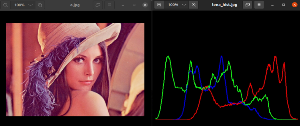

The running result of the 1_opencv_calcHist test case is as follows:
On the left is the original image, and on the right is the pixel histogram information of the 3 channels.

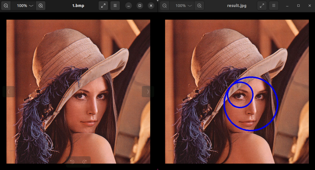

The running result of the 5_opencv_objdetect test case is as follows:
On the left is the original image, and on the right is the target detection result image for eyes and faces.
