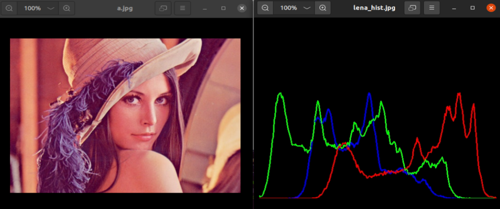

1_opencv_calcHistAn example of the running result of a test case is as follows:
test_opencv_calcHist
Among them, the left side is the original image, and the right side is the pixel histogram information of 3 channels.
