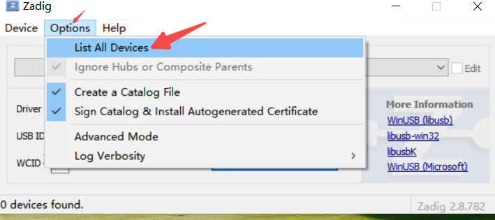

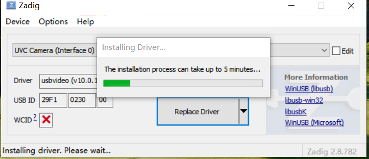

Double-click the
zadig-2.8.exesoftware in the release directory. After opening, click the menu bar: Options->List All Devices, and select this option.

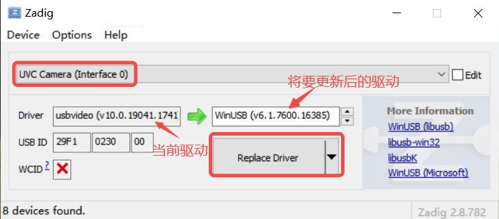

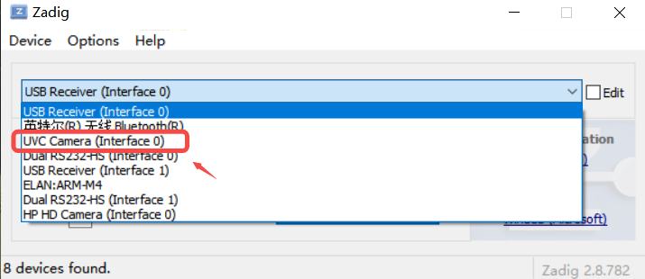

Select the K230 UVC device from the drop-down list, named “UVC Camera (interface 0)”.

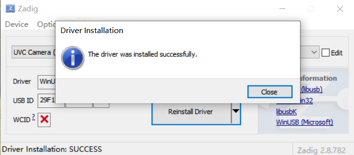

If the Windows driver for this device has not been updated, Windows will default to installing the “usbvideo” driver. In this case, it needs to be replaced with the “WinUSB” driver. Click the “Replace Driver” button to replace the driver.

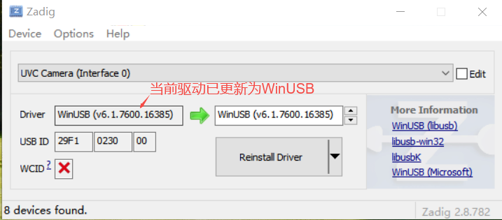

As shown in the above image, the “WinUSB” driver has been successfully installed. At this point, select the K230 UVC device again from the drop-down list, named “UVC Camera (interface 0)”, and it will show that the currently installed driver is “WinUSB”.
