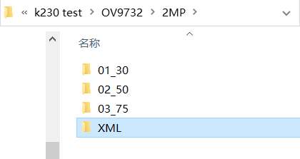

2.2 Creating Folders for Calibration Parameter Files#
Please follow the steps below to create folders for each resolution:
  1. Create a folder using the sensor name (e.g., /OV9732)
  2. Create a folder using the lens name (e.g., /2MP)
  3. Create a folder using the sample name (e.g., /01_30)
  4. Create subfolders for each calibration function (as shown in the figure below)
    Create folders
  5. Copy the calibration parameter files into the corresponding parameter folders
For each resolution, an example is as follows:

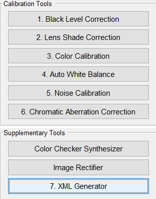

2.3 Generating the xml File Using the K230 ISP Calibration Tool#
After copying all calibration parameter files into the corresponding folders, open the K230 ISP Calibration Tool and use it to generate the xml file.
As shown in the figure below, click the “7. XML Generator” button on the main interface:
Main Interface
