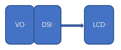

The K230 platform supports LCDs with MIPI-DSI interfaces. The hardware connection diagram between the LCD and the main control platform is as follows:
LCD Connection Diagram
The main control sends configuration information to the LCD through the MIPI-DSI interface while transmitting image data to the LCD.
