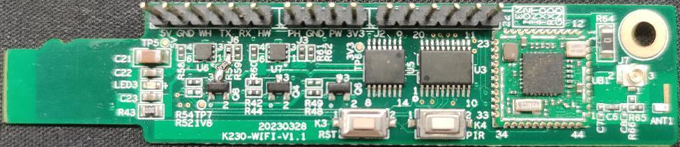

AiW4211LV10 is a low-power IoT WiFi chip, our company uses this chip platform to design an AiW4211LV10 development board, the development board can be connected to the K230 EVB board through the TF card slot. After the K230 EVB is loaded with the AiW4211LV10 driver, a wlan0 wireless card can be generated to realize network data communication.
WiFi daughter board
Figure 1-1 AiW4211LV10 development board
The main functions of WiFi are shown in Figure 1-1:
Block diagram of the WiFi function
Figure 1-1 WiFi function block diagram

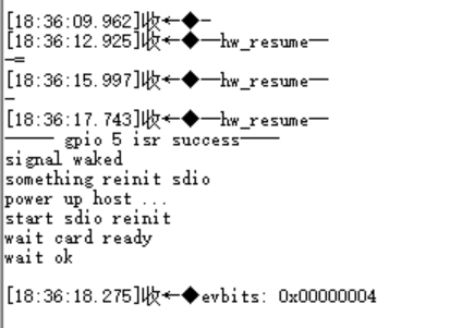

  • Sleep: Set the software and hardware environment, power down the host (according to the platform characteristics, the K230 is self-powered), and the WiFi enters sleep mode
  • IO wake-up: Processes button or PIR wake-up signals, restores the software and hardware environment, and powers up the host
  • Wake-on-LAN: Processes wake-up packets from keepalive links, restores the software and hardware environment, and powers up the host

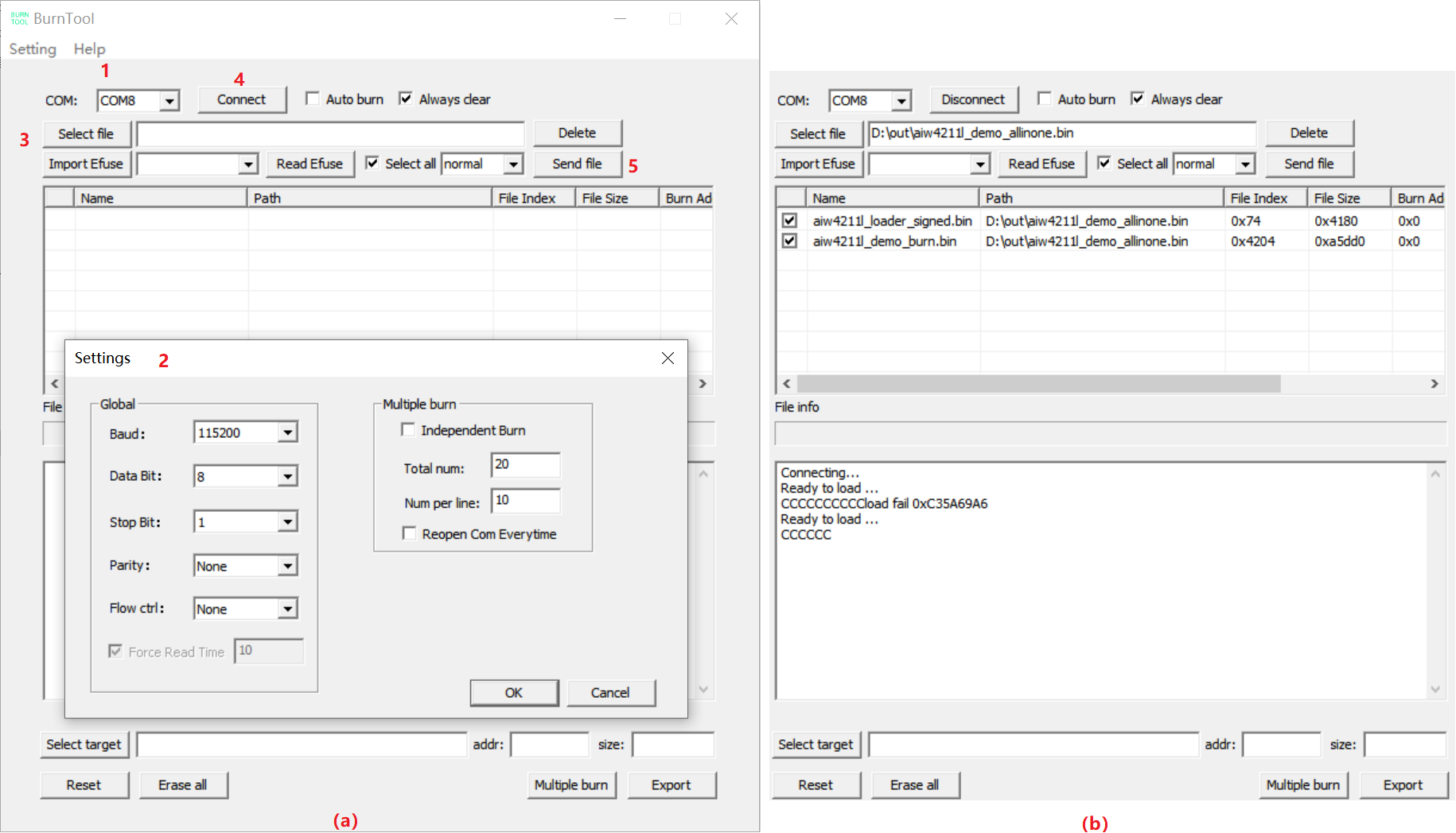

Use the BurnTool .exe of the programming tool in the WiFi SDK support directory to flash the firmware aiw4211l_demo_allinone.bin to the AiW4211LV10 development board through the serial port.
For programming methods, please refer to the document “AiW4211V10/AiW4211LV10 BurnTool Tool Tool User Guide.pdf”, which is stored in the support directory of the WiFi SDK.
Users can also contact Chengdu Aiqi Technology Co., Ltdhttp://www.aichtech.com/. for relevant information.
Figure 5-1 shows a schematic diagram of fast programming of veneers:
Burn 3
Figure 5-1 Rapid programming of veneer
Step 1: Choose to program the COM port Step 2: Configure COM port parameters through the “Setting” menu item Step 3: Select WiFi firmware step 4: Click the “Connect” control to initiate a connection to the WiFi development board, the WiFi development board is powered on, and the tool log window can see ready to load … , indicating that the connection has been established and can start flashing Step 5: Click the “Send file” control to start flashing

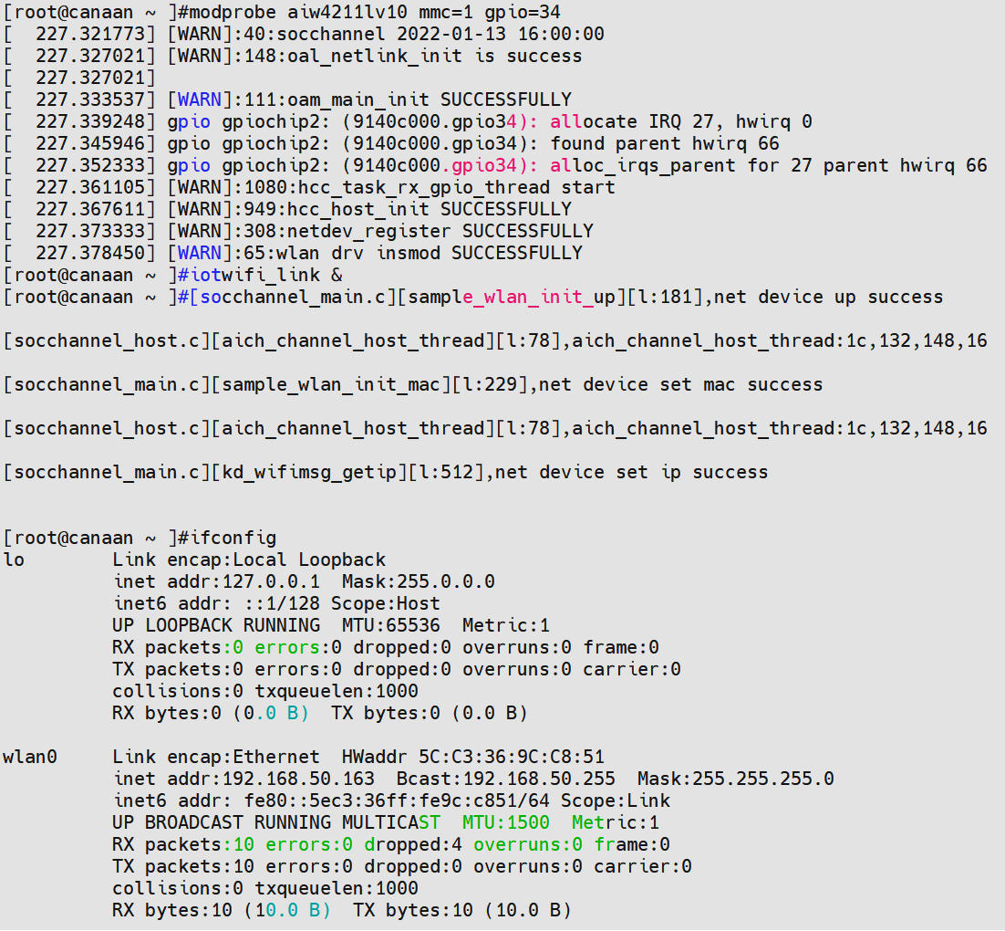

Refer to Section 2.2 to configure the hardware environment, press and hold the K1 button on the K230 EVB board to power on and start, and load the driver:
modprobe AIW4211LV10 or modprobe AIW4211LV10 MMC=1 GPIO=34
Start the configuration tool server side and run it in the background: iotwifi_link &
The current driver supports passing in the MMC master number and GPIO number for interrupt detection, which can achieve more flexible hardware configuration, and if no parameters are passed, the default values of 1 and 34 specified in the code are used respectively. iotwifi_link functions similar to wpa_supplicant, first up, and then synchronize the MAC address and IP address from the WiFi device side to the Host side.
Driver loading
Figure 5-2 Driver loading and iotwifi_link startup

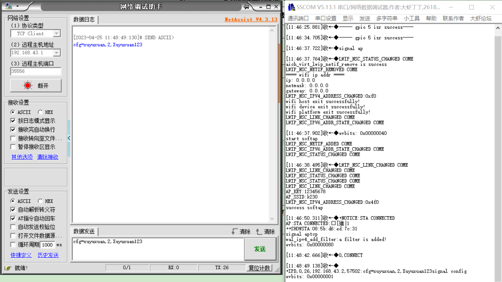

The AiW4211LV10 development board supports configuring the name, password, and encryption method of the target AP through the network. The steps to configure AP access are as follows:
Step 1: Prepare a router and record its hotspot name, password, and encryption method information Step 2: The AiW4211LV10 development board will start and run for the first time after the firmware is flashed, or long press the K4 button on the board for 3s after the configuration has been completed, WiFi will start the SoftAP mode to generate a hotspot and establish a socket server based on the TCP protocol Step 3: Connect your PC to the hotspot and start NetAssist Step 4: Configure NetAssist to connect to WiFi as a tcp socket client Step 5: After the server parses the configuration data, connect to the specified AP and exit the SoftAP mode
If the user has the ability, he can develop a mobile APP for network configuration, and here only the PC+NetAssist solution is used for simplicity. The SoftAP parameters and configuration data format are shown in Table 5-1, and the NetAssist configuration operation is shown in Figure 5-1:
Table 5-1 SoftAP parameters and configuration data format
Project
Parameters
AP name
K230
AP password
12345678
server ip
192.168.43.1
server port
35556
config data

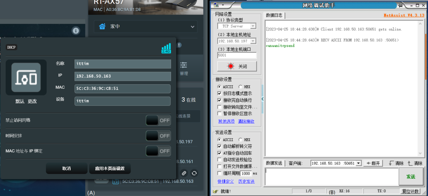

cfg=<targer ap name>,<targer ap auth>,<targer ap password> for example:cfg=xuyuxuan,2,Xuyuxuan123
SoftAP access
Figure 5-3 NetAssist configuration runs

config
Figure 5-4 (A) WiFi access router and assigned IP (B) tcp keepalive server

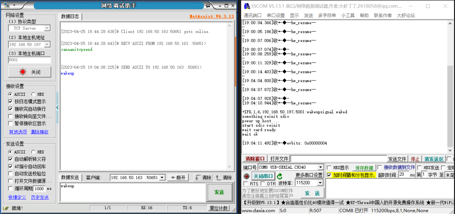

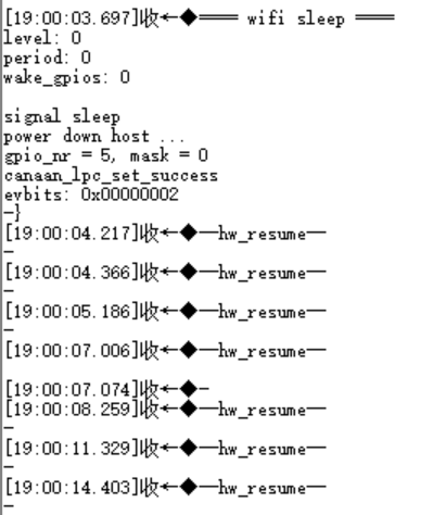

Run the configuration tool client to send a sleep command to trigger WiFi sleep: iotwifi_cli –dirsleep
enter sleep
Figure 5-5 WiFi enters the hibernation log
Sleep by Calling the API#
In the actual business program, WiFi sleep can be triggered by calling the API interface kd_wifi_sleep provided by the communication interface shared library libhal_iotwifi.so. Please refer to Chapter 6.2 for details.
The tool iotwifi_cli also triggers WiFi sleep by calling this interface.
