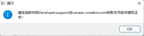

Issue 1: License prompt appears when AI Cube is opened#
license_error
Answer: AI Cube uses a license verification mechanism. To enter AI Cube, a license for the current month is required. Users can send an email to Developersupport@canaan-creative.com to apply for a license for the current month. Our professional team will provide you with license support.

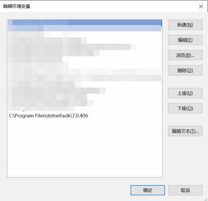

  • Incorrect dotnet environment variable configuration. Users can add environment variables in the system environment variable section, such as “C:\Program Files\dotnet\sdk\7.0.406”.
