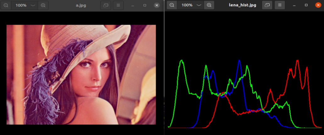

opencv_calcHist#
The running method of the 1_opencv_calcHist test case is as follows:
The running result of the 1_opencv_calcHist test case is as follows:
test_opencv_calcHist
On the left is the original image, and on the right is the pixel histogram information of the 3 channels.
