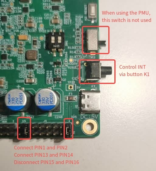

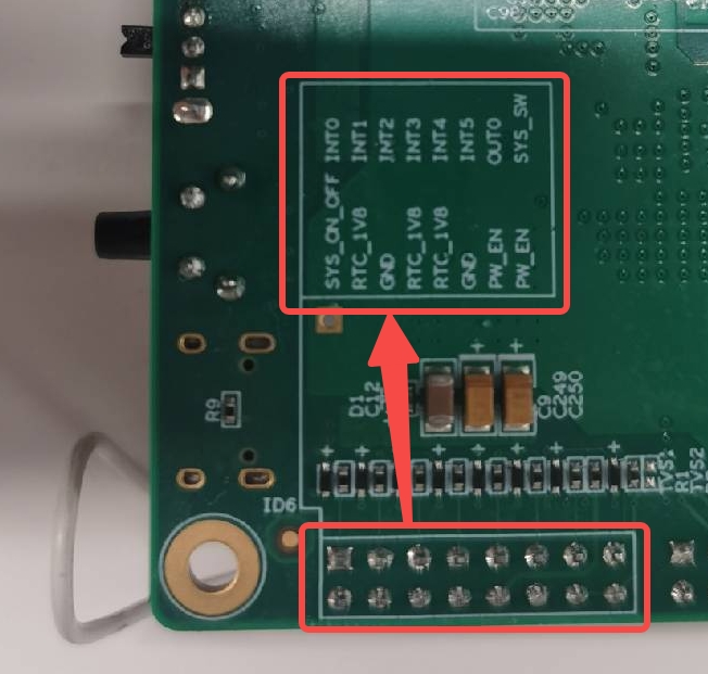

Hardware connection#
When using a PMU, you need to set up the EVB board as follows
  1. Use the jumper cap to connect PIN13(OUT0) and PIN14(PW_EN) of the J1 interface, taking care to disconnect PIN15(SYS_SW) and PIN16(PW_EN)
  2. Depending on the different wake-up source, PIN2 (SYS_ON_OFF) is connected to the corresponding PIN using a jumper, and the button K1 can control the state of INT, press the button to go high, and release it to low
    Wake source
    PIN
    label
    INT0
    INT0
    INT1
    3
    INT1
    INT2
    5
    INT2
    INT3
    7
    INT3
    INT4
    9
    INT4
    INT5
    11
    INT5
Connection diagram using INT0 as a wake-up source: top_view bottom_view
