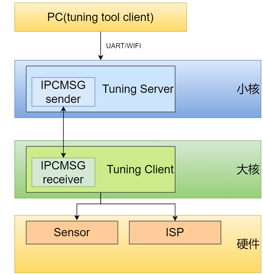

Module Software Architecture#
arch
Figure 1-1

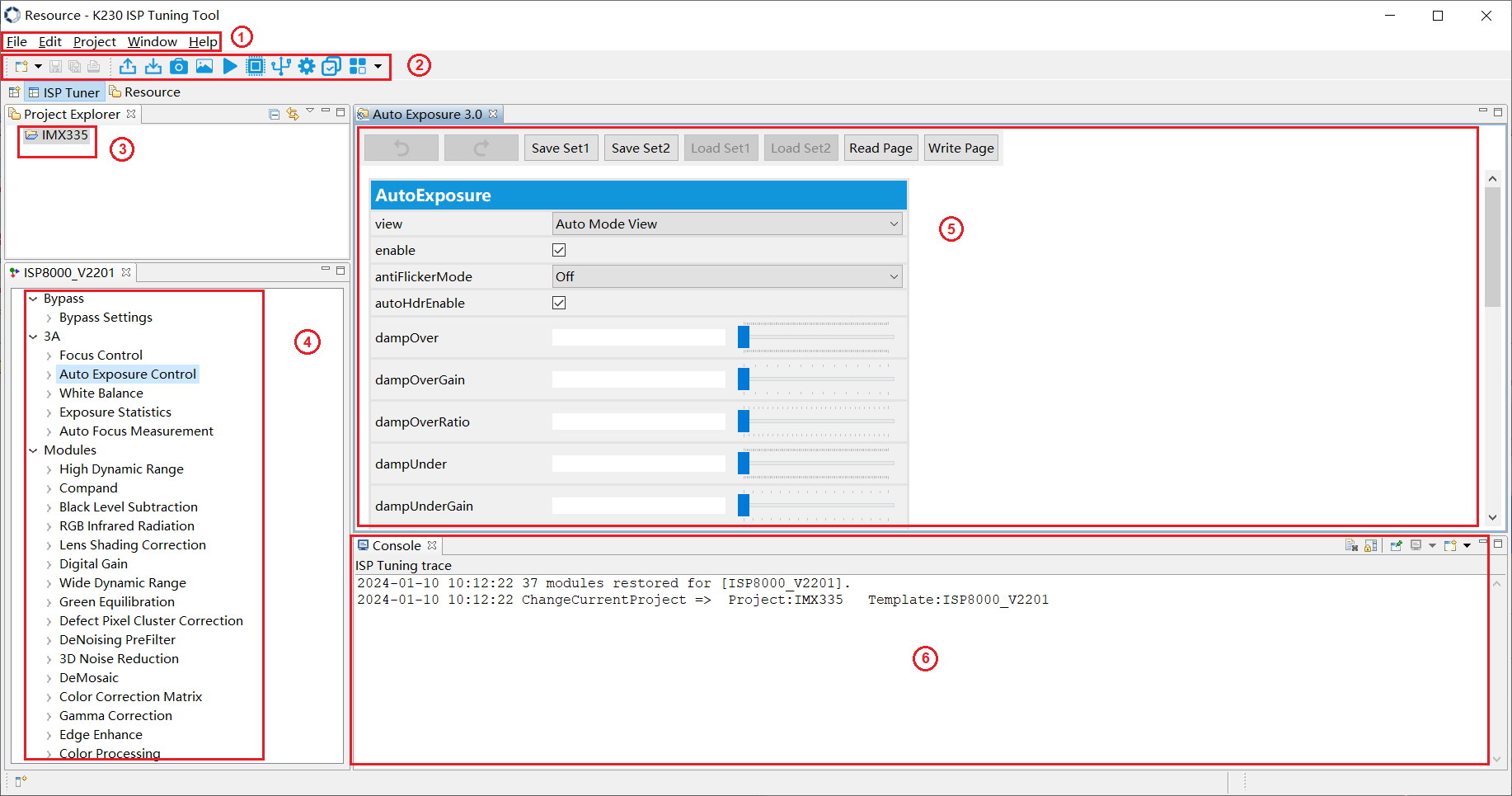

User Interface
Figure 3-1
As shown in Figure 3-1, the basic operation UI of the tuning tool is divided into six areas:
(1) Menu Operation Area: File operations, window management, etc.
(2) Toolbar Area: Supports key functions
Button
Export Settings
Export settings to a file
Import Settings
Import settings from a file
Capture Image or Video
Capture image or video
Send Local Raw Image or Video
Send local raw image or video to the debugging server for ISP processing
Video Preview
Video preview
Configure Registers
Configure registers
Configure Connection to Debugging Server
Configure connection to debugging server
Modify Preferences
Modify preferences
Batch Adjust Parameters
Adjust multiple parameters in one batch
Access Additional Components
Provide access to additional components
(3) Project Management Area: Select and manage different projects
(4) Function Area: Used for switching UI of various ISP modules
(5) Debugging Area: Used for debugging parameters of a specific module
(6) Echo Area: Used to print logs of parameter sending and receiving

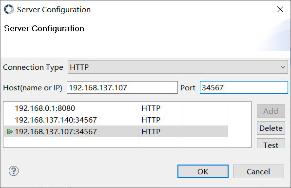

Connect to Board-side Tuning Server#
Connect to Board-side Tuning Server Using HTTP#
The SDK supports HTTP connection by default. Click the configure connection to debugging server button Configure Connection in the toolbar, and the window shown in Figure 3-2 will pop up.
HTTP Connection
Figure 3-2
Select HTTP mode, ensure that the PC and the board-side network are in the same subnet, enter the board-side IP in the “Host” input box, and enter the fixed port 34567 in the “Port” input box. After configuration, click the “OK” button. If the board-side tuning-server has been started, the connection will be automatically completed. Switch any module in area ④ of Figure 3-1 to see the function print of the tuning-server.

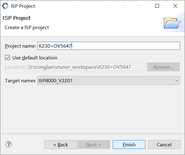

Create Debugging Project#

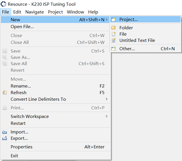

As shown in Figure 3-3, click File -> New -> Project… sequentially, and the project creation wizard window will pop up as shown in Figure 3-4.
New Project
Figure 3-3

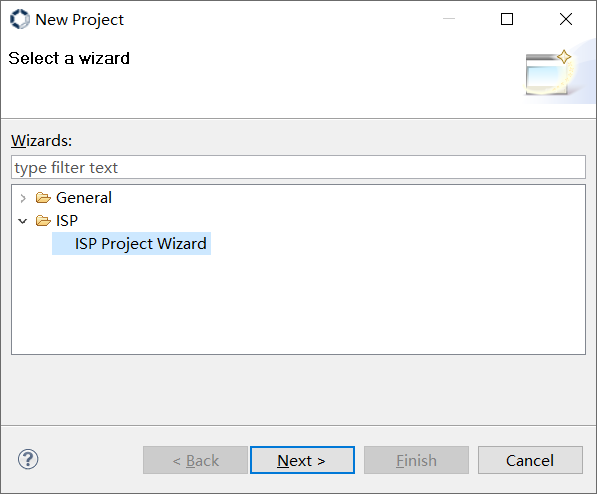

Project Wizard
Figure 3-4
Click the “ISP” directory to display the “ISP Project Wizard”. Click on “ISP Project Wizard” and then click the “Next” button to pop up the project creation window as shown in Figure 3-5.
Project Creation
Figure 3-5
Enter the project name, specify the project address, and click the “Finish” button to complete the project creation. The project will be displayed in area ③ of Figure 3-1. Click the project to start ISP debugging.

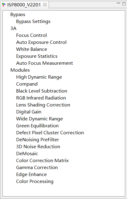

The ISP function modules are shown in Figure 3-6.
ISP Modules
Figure 3-6

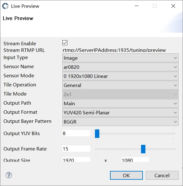

Set Image Format and Size#
Click the preview button in the toolbar Preview Button, and the window shown in Figure 3-7 will pop up.
Preview Window
Figure 3-7

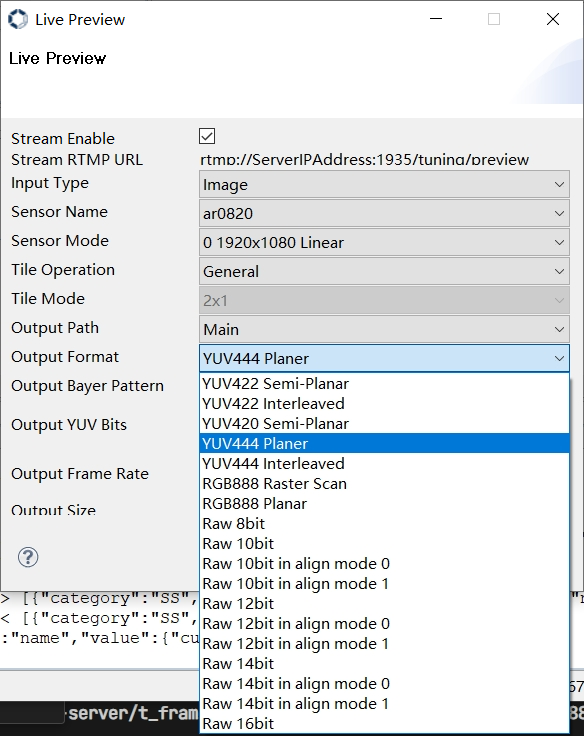

Check “Stream Enable”. In the “Output Format” section, select the image format you need to capture:
  • For capturing YUV images, currently only 8-bit yuvNV12 format data is supported, so select “YUV420 Semi_Planar”.
  • For capturing raw data images, select the appropriate bit width option according to the raw data bit width accessed by the ISP.
As shown in Figure 3-8, correctly set the image size in the “Output Size” section. Output Size Settings
Figure 3-8
Click the “OK” button to complete the settings.

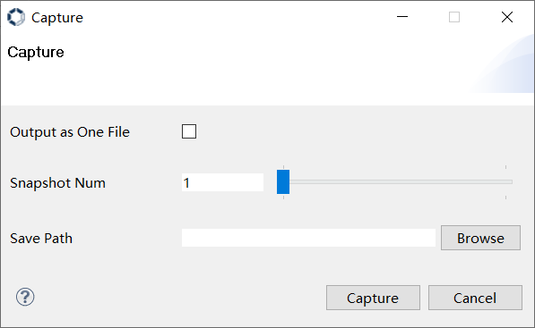

Capture Image#
Click the capture button in the toolbar Capture Button, and the window shown in Figure 3-9 will pop up.
Capture Window
Figure 3-9
In the “Save Path” section, select the location to save the image file.
  • To capture a single frame image, simply click the “Capture” button.
  • To capture multiple frames, set the number of frames to be captured in the “Snapshot Num” option and configure the “Output as One File” option (checked or unchecked) based on the desired number of output files. After completing the above configuration, click the “Capture” button to start capturing.

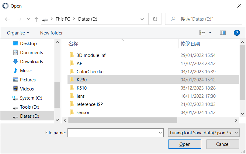

Click the import button in the toolbar Import Button, and the window shown in Figure 3-10 will pop up.
Import Window
Figure 3-10
In the window shown in Figure 3-10, select the XML or JSON parameter file you need to import, and click the “Open” button to start importing.
