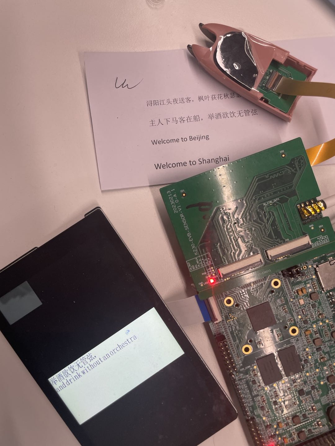

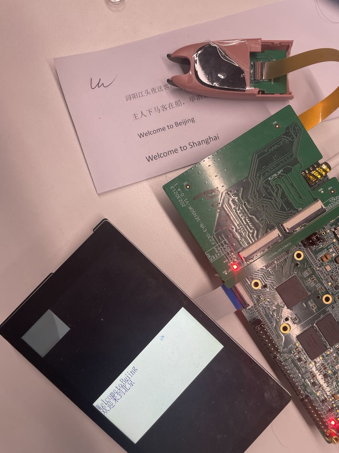

Function Demonstration#
The result of the program running, translating Chinese to English, is as follows: door_lock_menu
The result of the program running, translating English to Chinese, is as follows: door_lock_menu
