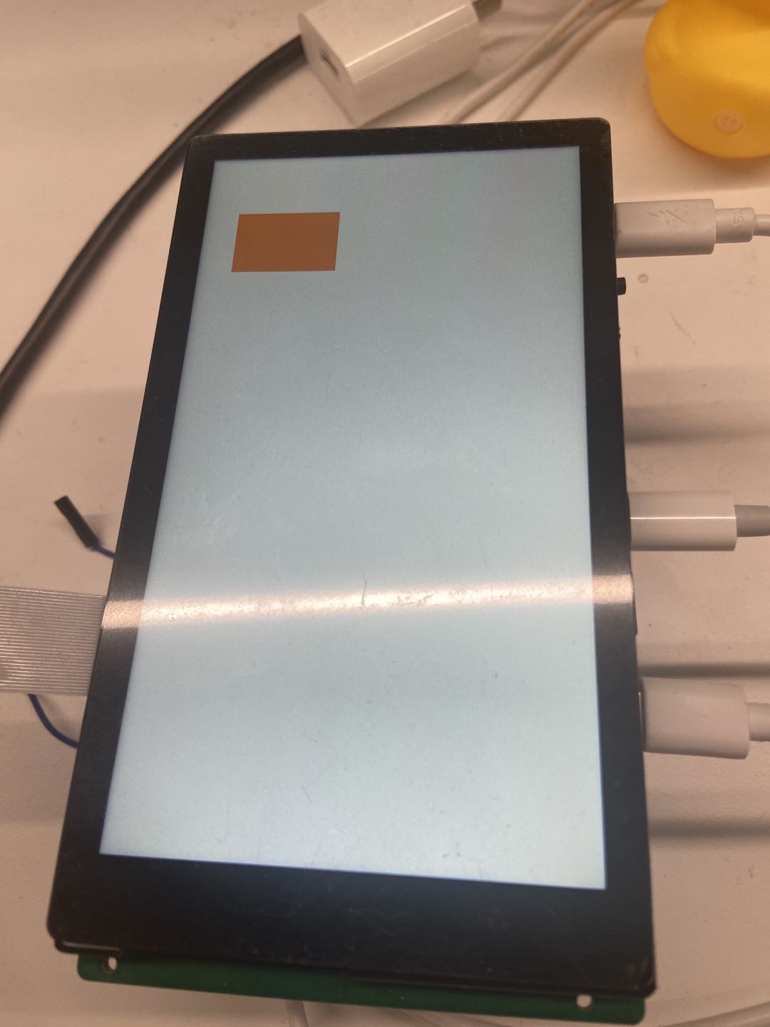

Display#
The K230 EVB has a 1080x1920 display. On the small-core Linux, DRM can be used for display. Letting the GPU driver load the DRM dumb buffer can reduce memory copying and achieve efficient rendering. The GPU+DRM related code can be referred to in the vglite_drm demo. Readers can add drm.c to their programs.
Note that as of K230 SDK v0.8, the DRM driver on Linux cannot work independently and relies on the configuration of the SoC video output module by the large core. This can be done by executing sample_vo.elf 3 on the large core.
Additionally, the color format enumeration of DRM does not completely match vg_lite_buffer_format_t. For example, VGLITE_BGRA8888 represents a 32-bit color with red in the lowest 8 bits and alpha in the highest 8 bits, corresponding to DRM_FORMAT_ARGB8888 in DRM.
vglite_drm demo result
The image above shows the correct color displayed on the screen after running the vglite_drm demo: R(255)G(128)B(16).
Generally, to achieve synchronized display, two buffers are needed for ping-pong alternating display. However, to simplify the demonstration code, only one buffer is used here. Readers can implement double buffering with vertical synchronization for continuous rendering.

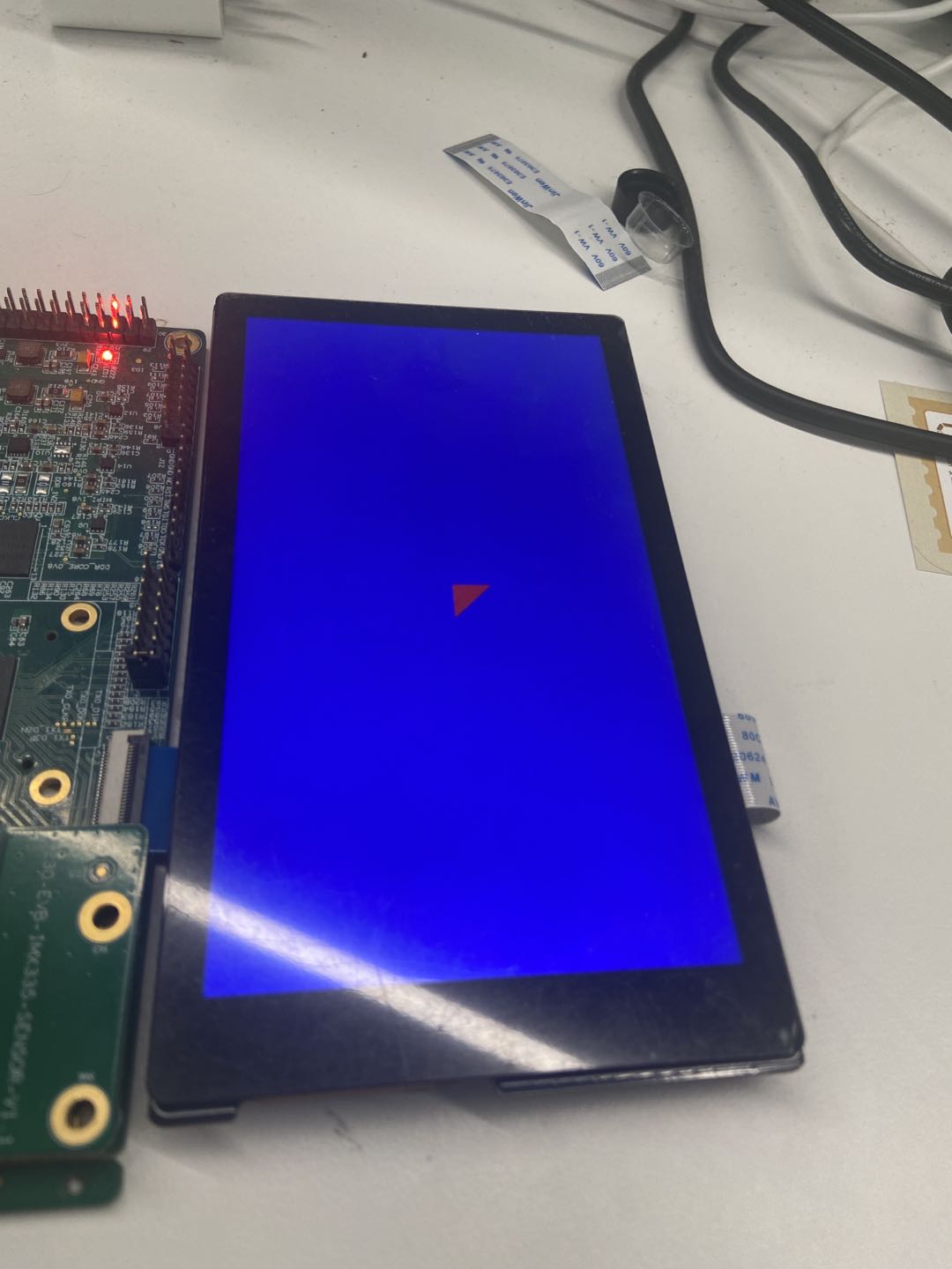

Polygon#
With a buffer, you can start drawing. A polygon is composed of multiple lines. Taking a triangle as an example, first determine the coordinates of the three vertices of the triangle, such as (0,0) (0,1) (1,0). The entire process is as follows:
  1. Move the pen to (0,0)
  2. Draw a line to (0,1)
  3. Draw a line to (1,0)
  4. Draw a line to (0,0)
  5. Close the shape
Refer to the K230 GPU API reference to see that the opcode for moving is 2, the opcode for drawing a line is 4, and the opcode for closing the path is 0. Using the first data format, you can construct the path_data array as follows:
uint8_t path_data[] = {
    2, 0, 0, // Move to (0,0)
    4, 0, 1, // Line to (0,1)
    4, 1, 0, // Line to (1,0)
    4, 0, 0, // Line to (0,0)
Only path_data is not enough. Rendering requires a path, which includes not only path_data but also information such as data format. The data format can be specified as one of the following:
  1. 8-bit signed integer
  2. 16-bit signed integer
  3. 32-bit signed integer
  4. 32-bit floating-point number
From top to bottom, performance decreases sequentially. However, even an 8-bit signed integer does not mean that it can only cover the pixel range from -128 to 127, because matrix transformations are also needed to calculate the final coordinates. Now construct the path and draw it to the buffer:
vg_lite_path_t path = {
    .bounding_box = {0., 1., 1., 0.}, // Bounding box of the shape
    .quality = VG_LITE_HIGH, // Rendering quality
    .format = VG_LITE_S8, // Considering the coordinates are simple, 8-bit is sufficient
    .uploaded = 0, // The path hasn't been uploaded to the GPU, so use 0
    .path_length = sizeof(path_data), // Length of the path data in bytes
    .path = path_data, // The path data is placed here
    .path_changed = 1, // Indicates the path has been updated
    .pdata_internal = 0 // Indicates the path data is not allocated by the driver
With the above variables, you can perform rendering with the following steps:
  1. Clear the buffer, i.e., fill it with a single color, which can be done using vg_lite_clear.
  2. Create a transformation matrix. For information on matrices, refer to affine transformations. Here, we directly use a scaling matrix to enlarge the image by 100 times, so a line of length 1 will use 100 pixels in the image.
  3. Call vg_lite_draw to “render” the path to the buffer.
  4. Finally, use vg_lite_finish to submit the rendering.
To facilitate error handling, use the CHECK_ERROR macro to wrap functions that return vg_lite_error_t.
vg_lite_matrix_t matrix;
CHECK_ERROR(vg_lite_clear(&buffer, NULL, 0xffff0000)); // Fill the entire buffer with blue
vg_lite_identity(&matrix); // Initialize to the identity matrix
vg_lite_translate(buffer.width / 2., buffer.height / 2., &matrix); // Move to the center of the buffer
vg_lite_scale(100., 100., &matrix); // Scale by 100 times in both x and y directions
CHECK_ERROR(vg_lite_draw(
    &buffer, &path,
    VG_LITE_FILL_NON_ZERO, // Fill rule, pixels are drawn as long as they are covered
    &matrix,
    VG_LITE_BLEND_NONE, // Color blending rule, None means ignore transparency and directly overwrite
    0xff0000ff // RGBA color, this value represents opaque red
CHECK_ERROR(vg_lite_finish()); // Submit to the GPU
The complete reference code can be found in vglite_drm, and the result of the drawing is shown below.
Simple drawn triangle
It is easy to see that the coordinate system has the positive x direction to the right and the positive y direction downward, which is also the coordinate system used by SVG.
It should be noted that when I mentioned “rendering” with vg_lite_draw, it was in quotes because it doesn’t actually render; it just writes the rendering commands. The final rendering requires calling vg_lite_finish, which is beneficial for performance. In practical use, you can call vg_lite_draw multiple times and then execute vg_lite_finish just before the actual display, since vg_lite_finish is a system call with some overhead, while vg_lite_draw is not and can be executed very quickly.
After rendering is complete, you can display the result on the screen or save it as an image. Note that when saving an image, the CPU reads the data, so you need to ensure that vg_lite_buffer_t::memory is readable. If you use the DRM code above to create vg_lite_buffer_t, you won’t be able to read it if the DRM dumb is not mapped.

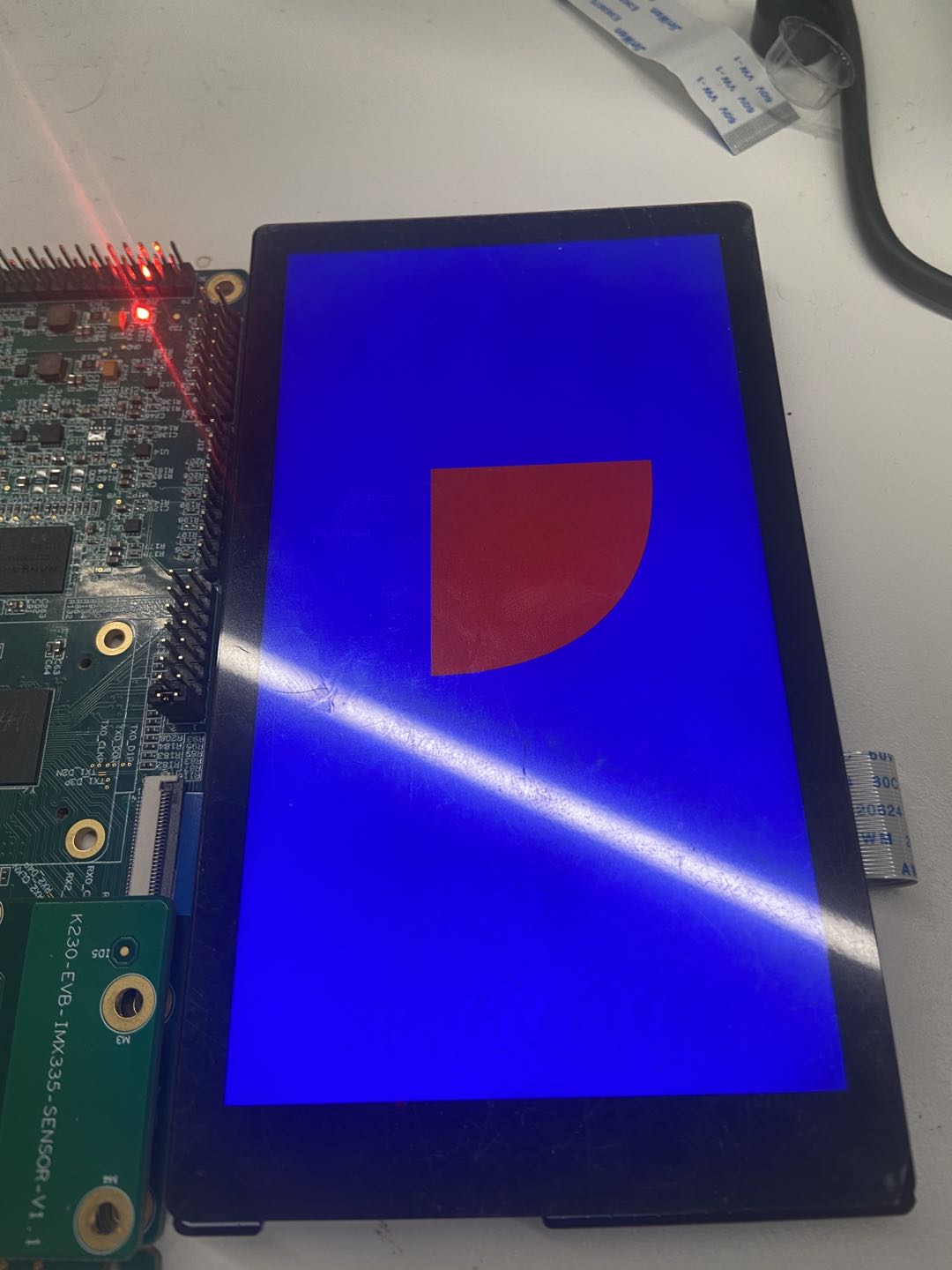

Curves#
The K230 GPU supports three types of curves:
  1. Quadratic Bézier curves
  2. Cubic Bézier curves
  3. Elliptical arcs
Of course, elliptical arcs can be approximated using cubic Bézier curves, essentially making them the same type of curve. Similar to drawing polygons, you only need to modify the opcodes and data.
Let’s try changing the bottom edge of the previously drawn triangle to a quadratic Bézier curve, with the midpoint at (1,1), to draw a shape resembling a rounded corner. Modify the path_data as follows:
    2, 0, 0,
    4, 0, 1,
    6, 1, 1, 1, 0, // Quadratic Bézier curve, control point (1,1), draw to (1,0)
    4, 0, 0,
To better observe this curve, increase the scaling factor, say to 500 times, and adjust the translation to approximately center the shape on the screen.
The final drawn shape looks like this:
Approximate rounded sector
