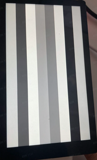

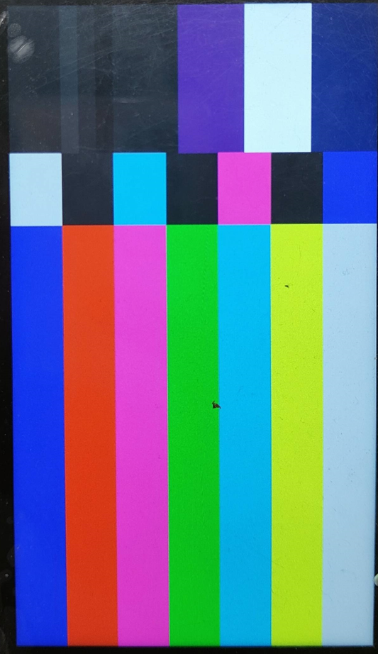

To run the DSI self-test mode demo:
./sample_vo.elf 2
A color bar image will be displayed on the screen, as shown below:
Auto-generated background pattern description

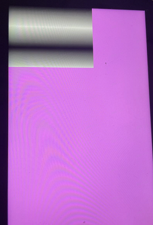

  1. To run the VO and VVI binding demo:
    ./sample_vo.elf 9
    Press Enter once to start sending ARGB data from VVI, press Enter again to exit the program. The display effect alternates between red, green, and blue primary colors, as shown below:
    Image description

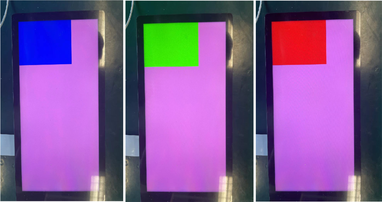

  2. To run the VO layer frame insertion demo:
    ./sample_vo.elf 7
    After executing the command, press Enter once to insert an image from the user layer, press Enter again to exit the program. The display effect is as follows:
    Image description

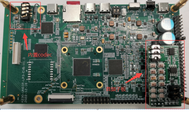

Dependency Resources#

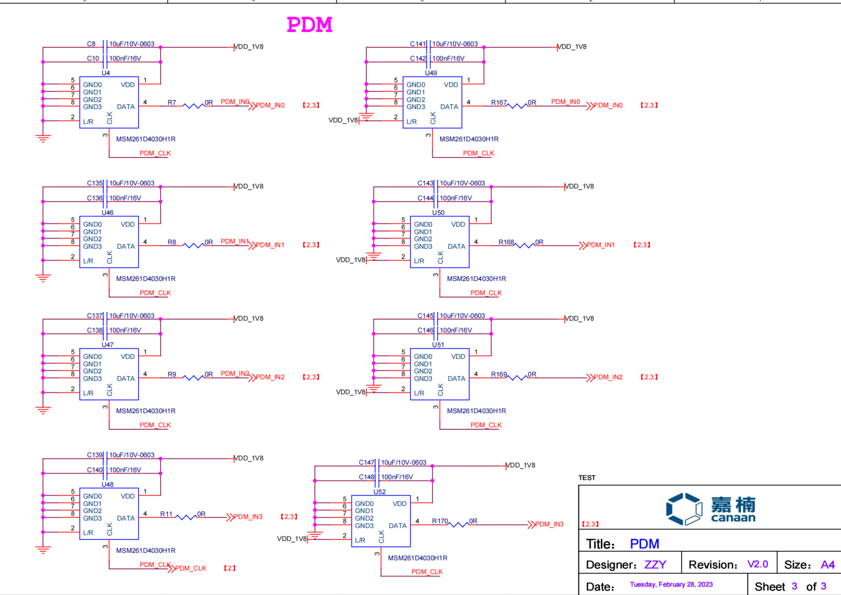

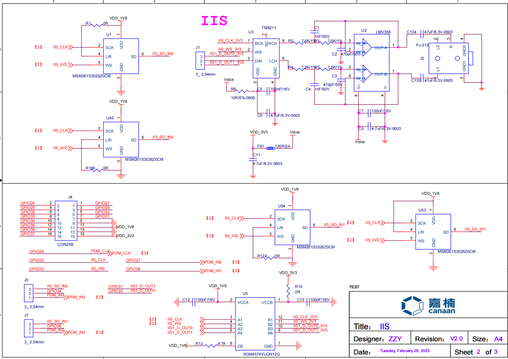

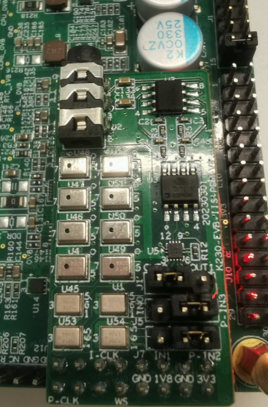

  1. Audio testing depends on the audio sub-board.
The audio sub-board schematic is as follows:
Diagram, schematic
Diagram, schematic

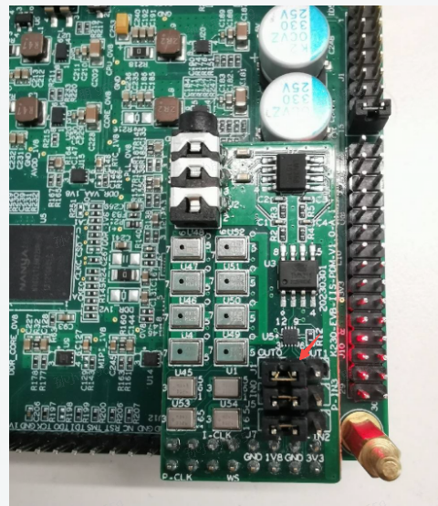

When testing i2s input and output, the audio sub-board can be connected as follows using jumper caps:
Jumper caps for i2s
For pdm audio collection, when collecting data from the 0th or 1st pdm channel, it does not conflict with i2s pins.
When using the 2nd and 3rd pdm channels, jumper caps are needed to switch to pdm channel mode, as follows:
Jumper caps for pdm

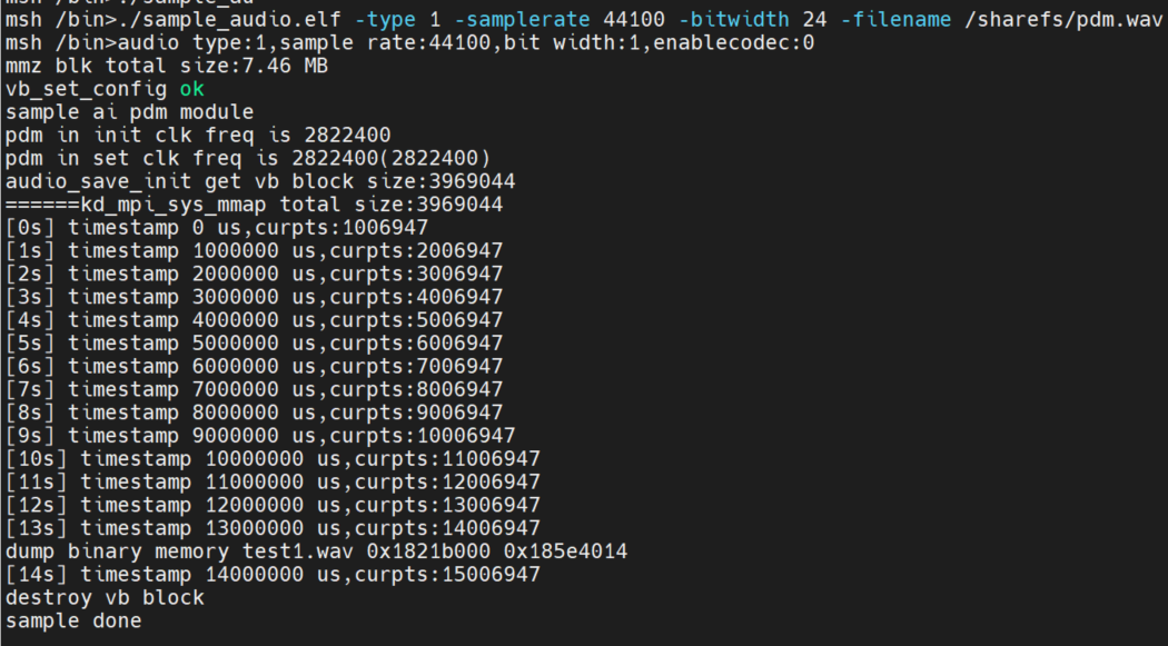

PDM Audio Input Test#
  • Input ./sample_audio.elf -type 1 to collect 15s of pcm audio data.
  • Use the -samplerate option to select the sampling rate for audio collection.
  • Use the -bitwidth option to set the sampling precision.
  • Use the -enablecodec option to set whether to use the built-in codec. After collecting 15s of data, the demo automatically exits and saves the data to a file.
The demo implementation idea: This test collects data by looping the API functions: kd_mpi_ai_get_frame and kd_mpi_ai_release_frame. Note that the ai dev number corresponding to pdm is 1.
pdm in log

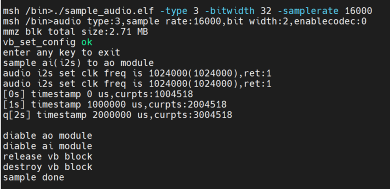

Input ./sample_audio.elf -type 3 -bitwidth 32 to test audio input and output functionalities in real-time through the API interface.
The overall functionality of audio input and output is tested by calling the API interface: kd_mpi_ai_get_frame to get audio data and kd_mpi_ao_send_frame to output audio data. Users can press any key to exit the function test. During the test, the timestamp information collected by ai is output in real-time.
Text description auto-generated

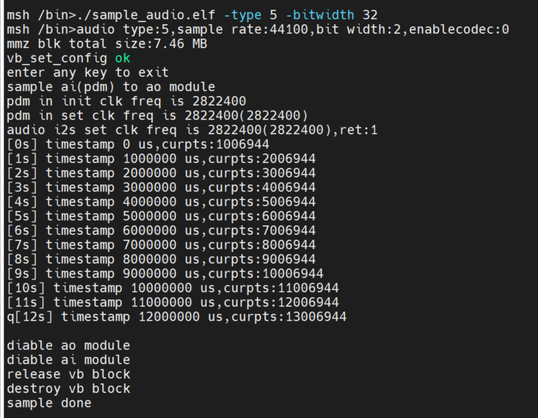

PDM Audio Input, I2S Output API Interface Test#
Input ./sample_audio.elf -type 5 -bitwidth 32 to test audio input and output functionalities in real-time through the API interface.
pdm in i2s out log

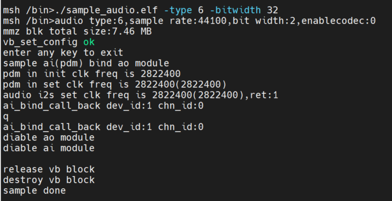

PDM Audio Input, I2S Output System Binding Test#
Input ./sample_audio.elf -type 6 -bitwidth 32 to test audio input and output functionalities in real-time by binding the ai and ao modules.
The overall functionality of audio input and output is tested by calling the system binding API interface: kd_mpi_sys_bind to bind the ai and ao modules. Users can press any key to exit the function test.
pdm in is2 out bind

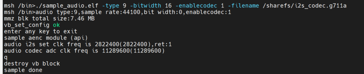

Encoding Test#
Collect ai data and encode it to save to a file. Encoding and decoding only support g711a/u, 16bit.
System binding method: ./sample_audio.elf -type 7 -bitwidth 16 -enablecodec 1 -filename /sharefs/i2s_codec.g711a
audio enc bind log
API interface method: ./sample_audio.elf -type 9 -bitwidth 16 -enablecodec 1 -filename /sharefs/i2s_codec.g711a
audio enc log

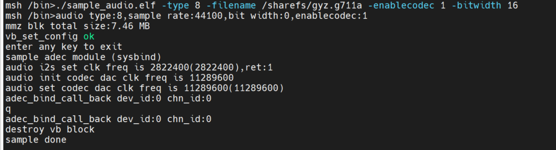

Decoding Test#
Read file data and decode it for playback. Encoding and decoding only support g711a/u, 16bit.
System binding method: ./sample_audio.elf -type 8 -filename /sharefs/gyz.g711a -enablecodec 1 -bitwidth 16
audio dec bind
API interface method: ./sample_audio.elf -type 10 -filename /sharefs/gyz.g711a -enablecodec 1 -bitwidth 16
audio dec

  1. ai->aenc, adec->ao two paths binding loopback test. Use the built-in codec with 16bit precision for simulation.
Simultaneously test the timestamp of the stream after g711 encoding.

MAPI Audio Test#
Ensure the inter-core communication process is started on the large core: execute on the large core: /bin/sample_sys_init.elf & Ensure the small core loads the inter-core communication driver module: insmod /mnt/k_ipcm.ko
  • You can input /mnt/sample_audio -help to view the demo usage method.
  • Use the -type option to test different module functions.
  • Use the -samplerate option to configure different sampling rates for audio input and output (8k-192k), with a default of 44.1k.
  • Use the -enablecodec option to use the built-in codec or external audio sub-board, with the built-in codec used by default.
  • Use the -filename option to load or save g711 files.
  • Use the -channels option to specify the number of channels.
image-20230530101801685
  • ai->aenc test
Execute the command on the small core: /mnt/sample_audio -type 0 -filename test.g711a, press the q key to exit the test. The demo can collect audio data in real-time, encode it into g711a format, and save it to a file.
image-20230530102014642
  • adec->ao test
Execute the command on the small core: /mnt/sample_audio -type 1 -filename tes.g711a, press the q key to exit the test. The demo can loop decode and play local g711a format files.
Translation to English#
image-20230530102747862
  • ai->aenc adec->ao loopback test
Execute the command on the small core: /mnt/sample_audio -type 2, press the q key to exit the test. The demo can collect audio data in real-time, encode it into g711a format, and then decode the g711a format data for playback output. image-20230530102916366

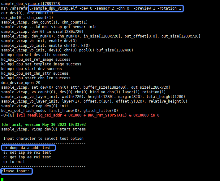

Vicap_demo#
Introduction to vicap_demo#
The vicap demo implements camera data collection and preview functionality by calling the mpi interface.
Feature Description#
The current version supports image collection and preview for three camera modules: OV9732, OV9286, and IMX335. It supports up to three data streams per camera and up to three camera data inputs.
Camera module
Usage Instructions#
Compilation#
  1. Execute make mpp-clean && rt-smart && make build-image in the k230_sdk directory to compile the modifications into the SD card image. The image file sysimage-sdcard.img will be generated in the k230_sdk/output/k230_evb_defconfig/images/ directory.
Execution#
  2. Mount this directory to the small core Linux /sharefs via NFS.
  3. On the large core, navigate to /sharefs using the cd /sharefs command.
When the sample_vicap command is entered, the following prompt information is printed:
Options:
 -mode:         vicap work mode[0: online mode, 1: offline mode. only offline mode supports multiple sensor input]     default 0
 -ofmt:         the output pixel format[0: yuv, 1: rgb888, 2: rgb888p, 3: raw], only channel 0 supports raw data, default yuv
Parameter description:
Parameter Name
Optional Values
-dev
0: vicap device 0, 1: vicap device 1, 2: vicap device 2.
Specifies the vicap device to use. The system supports up to three vicap devices. By specifying the device number, the binding relationship between the sensor and different vicap devices is achieved. For example: -dev 1 -sensor 0 means binding the OV9732 1280x720 RGB image output to vicap device 1.
-mode
Specifies the work mode of the vicap device. Currently supports online and offline modes. For multiple sensor inputs, it must be specified as offline mode.
-sensor
0: ov9732@1280x720, 1: ov9286_ir@1280x720, 2: ov9286_speckle@1280x720, 3: imx335_2lan@1920x1080, 4: imx335_2lan@2592x1944, 5: imx335_4lan@2592x1944
Specifies the type of sensor to use. The current system supports three types of image output: OV9732 1280x720 RGB image output, OV9286 1280x720 infrared image output, OV9286 1280x720 speckle image output. The IMX335 outputs RGB images.
-chn
0: vicap device output channel 0, 1: vicap device output channel 1, 2: vicap device output channel 2.
Specifies the output channel of the vicap device. A vicap device supports up to three outputs, only channel 0 supports RAW image format output.
-ow
Specifies the output image width, default is the input image width. The width needs to be aligned to 16 bytes. If the default width exceeds the maximum display output width, the display output width will be used as the final output width. If the output width is smaller than the input image width and the ox or oy parameters are not specified, it defaults to scaled output.
-oh
Specifies the output image height, default is the input image height. If the default height exceeds the maximum display output height, the display output height will be used as the final output height. If the output height is smaller than the input image height and the ox or oy parameters are not specified, it defaults to scaled output.
-ox
Specifies the horizontal starting position of the image output. If this parameter is greater than 0, crop operation will be performed.
-oy
Specifies the vertical starting position of the image output. If this parameter is greater than 0, crop operation will be performed.
-crop
0: Disable crop function, 1: Enable crop function
-ofmt
-preview
0: Disable preview display, 1: Enable preview display
Specifies the output image preview display function. Default is enabled. Currently supports up to 2 output image previews simultaneously.
-rotation
0: rotate 0 degrees, 1: rotate 90 degrees, 2: rotate 180 degrees, 3: rotate 270 degrees, 4: unsupported rotation, 17 use gdma rotate 90 degrees, 18 use gdma rotate 180 degrees, 19 use gdma rotate 270 degrees
Specify the rotation angle of the preview display window. only the first output image window supports the vo rotation function, all output image window supports gdma rotation function.
Example 1:
Description: Binds OV9732@1280x720 RGB to vicap device 0, and enables vicap device output channels 0 and 1. Channel 0 output size defaults to input image size (1280x720), channel 1 output image size is 640x480.
Example 2:
Description: Three-way input and output. Binds OV9732@1280x720 RGB to vicap device 0 and sets channel 0 output size to 1080x720; binds OV9286@1280x720 infrared to vicap device 1 and sets channel 0 output size to 1080x720; binds OV9286@1280x720 speckle to vicap device 2 and sets channel 0 output size to 1080x720 (no preview).

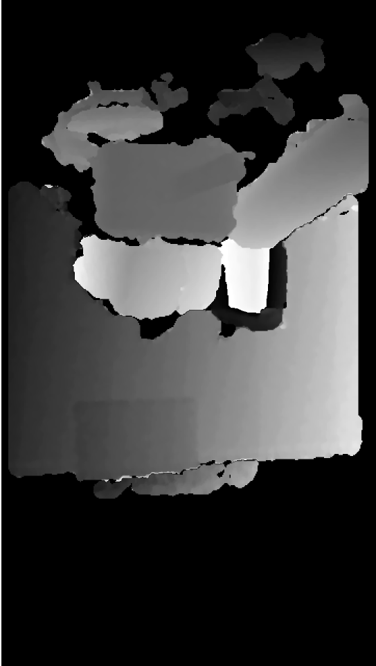

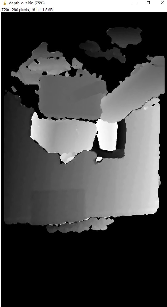

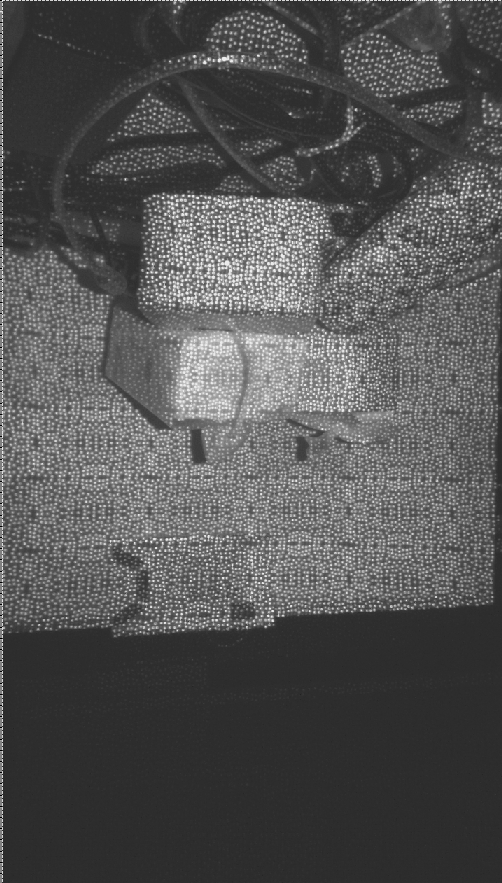

DPU_demo#
Introduction to dpu_demo#
Non-binding Mode#
Parses parameters from the configuration file and configures the DPU’s device and channel attributes, reads and configures reference and template images from the specified path, loops input of infrared and speckle images, obtains results and checks if the calculations are correct.
Binding Mode#
Parses parameters from the configuration file and configures the DPU’s device and channel attributes, reads and configures reference and template images from the specified path, binds the pipeline using VVI as the simulated front-end, inputs infrared and speckle images, DPU calculates the results, user space obtains the results and saves the depth map as a file (the depth map can be opened with appropriate software), press q to exit the program.
Includes configuration file parsing, device and channel attribute configuration, device and channel start and stop, user space input data, output results, release results, and pipeline binding input and output.
None
Usage Instructions#
Compilation#
Refer to the README.md in the SDK for the software compilation environment. Since this module requires dependent files, the following steps need to be performed during compilation:
Execution#
  1. The configuration files and input/output golden data required for the demo are stored in the k230_sdk/test_resource/dpu directory. To facilitate use, you can copy the entire dpu folder to the /sharefs/ directory (refer to the corresponding documentation for the use of sharefs). After copying, the /sharefs/dpu/ directory will exist in the large core.
  2. Copy k230_sdk/src/big/mpp/userapps/sample/elf/sample_dpu.elf to the /sharefs/ directory.
  3. Non-binding mode demo run
    Test information will be displayed on the screen, and the run will end after 10 frames. In the above command, the parameter /sharefs/dpu/ can be set according to the actual path where the user’s configuration files are stored.
  4. Binding mode demo run
    Test information will be displayed on the screen, input q to end the run. In the above command, the parameter /sharefs/dpu/ can be set according to the actual path where the user’s configuration files are stored.

vglite_drm#
Run the vglite_drm command. The GPU will display the pattern on the LCD screen, and pressing the Enter key again will display the next pattern, as shown below:
First Pattern
Second Pattern

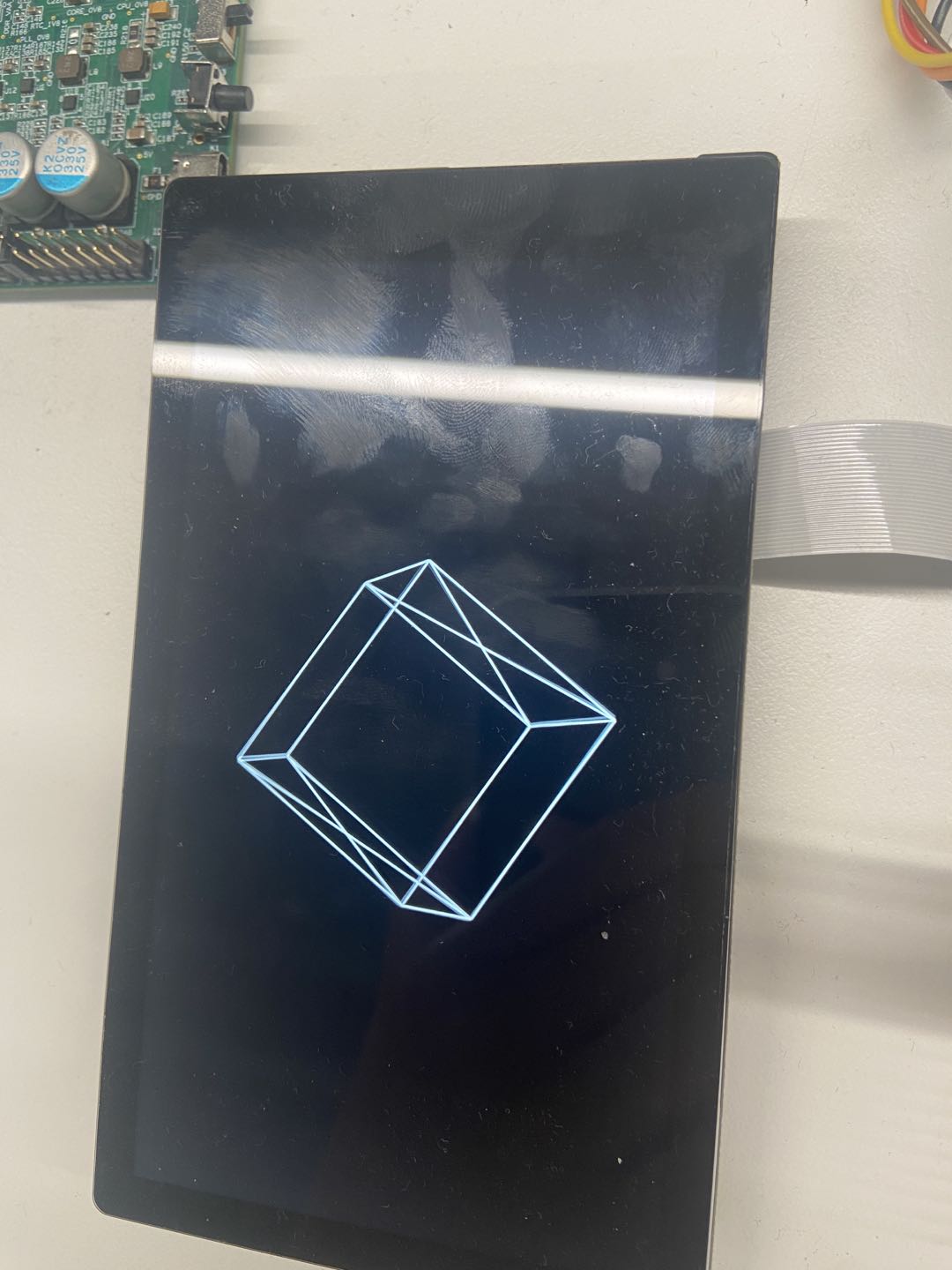

vglite_cube#
Run the vglite_cube command. The GPU will display a rotating cube on the LCD screen, as shown below:
Cube

DRM Display Demo#
Introduction to the Demo#
This demo runs on the Linux system of the K230 small core and displays images on the screen.
  1. DRM supports operations on 5 layers, including 1 video layer and 4 OSD layers.
LCD screen.
Usage Instructions#
Compilation#
Execution#
modetest -M canaan-drm -D 0 -a -s 38@36:1080x1920-30  -P 31@36:1080x1920@NV12 -v -F smpte
After executing the above command, a color bar will be displayed on the LCD screen, as shown below:
Image Description

  2. Use the command ./sample_dpu_vicap.elf -dev 0 -sensor 2 -chn 0 -preview 1 -rotation 1 to start the demo. The output print information is as follows:
    run

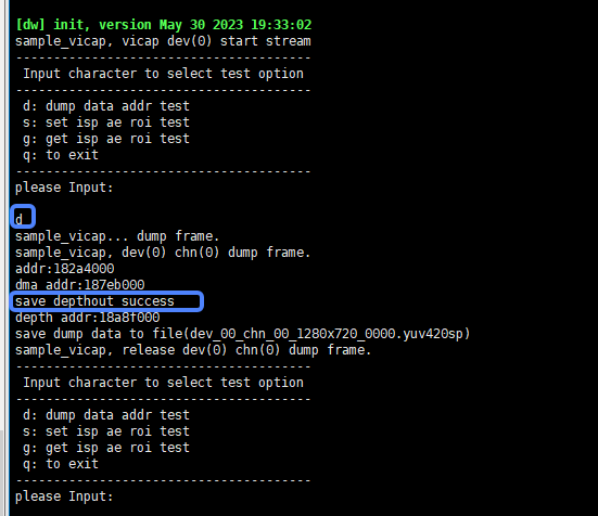

  3. Input d, the output print information is as follows:
    save
  4. Input q to exit the program.

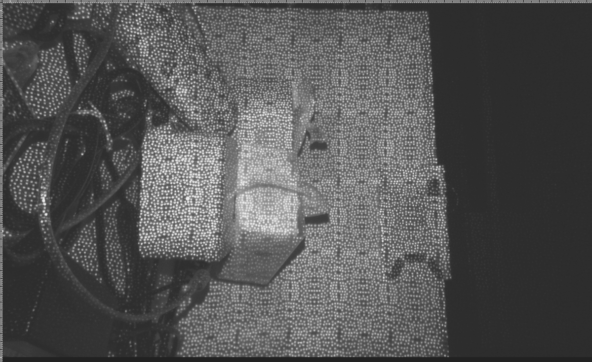

  2. The speckle image captured by the sensor is as follows:
    vicap

  4. The depth image result output by DPU is as follows:
    dpu
