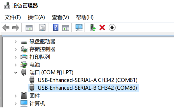

View the serial port number
windows-serial
Two serial ports are displayed here: COM80 for the small core Linux debug serial port, and COM81 for the large core rt-smart debug serial port.

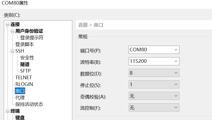

Configure serial port information
Open the Xshell tool (or other serial port tools).
  1. Select the port number displayed in the Device Manager
  2. Baud rate: 115200
  3. Data bits: 8
  4. Stop bits: 1
  5. Parity: None
  6. Flow control: None

Powering Up and Starting the Development Board#
Install MobaXterm for serial communication. Download MobaXterm from: https://mobaxterm.mobatek.net.
CanMV-K230_debug
Insert the burned SD card into the board’s card slot, connect HDMI output to a monitor, connect the Ethernet port to a network, and connect the POWER port for serial communication and power supply.
After powering up the system, there will be two serial devices by default, which can be used to access the small-core Linux and the big-core RTSmart systems.
The default username for the small-core Linux is root, with no password. In the big-core RTSmart system, an application will automatically start on boot, which can be exited to the command prompt terminal by pressing the q key.
