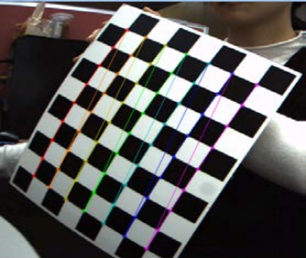

Capturing Images#
  1. Rotate the chessboard on the same plane and capture at least 20 images.
  2. Select at least 10 photos covering all angles and save them to a fixed directory. It is recommended to choose images with significant differences.
Calibration Image Example
You can use the sample_vicap.elf program to capture images. Convert the saved YUV files to png/bmp formats that are easily readable by OpenCV using ffmpeg, as shown in the following command:

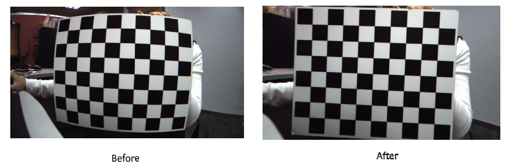

Lens correction uses the Brown-Conrady distortion model. Input parameters include u0, v0, fx, and fy from the camera’s internal matrix, distortion coefficients k1, k2, p1, p2, k3, k4, k5, and k6, and fovRatio. These parameters can be obtained from the previous calibration step. The correction effect is as follows:
Correction Effect

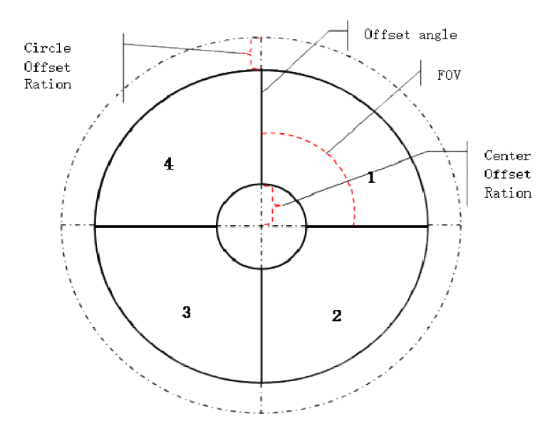

The split screen mode does not require camera calibration.
Each sector image in the figure below is corrected to a small rectangular split screen image. The calculation method for each small split screen image is similar. After calculating each small image, the corresponding coordinate arrays of each small image need to be concatenated into the coordinate array of the large image. For example, the coordinate calculation process of one small image is as follows. Input parameters include CenterOffsetRatio, CircleOffsetRatio, maxRadius, image width, and image height, which are the dimensions of each small output image, and the center point centerX and centerY of the input image. The output outputX and outputY are coordinates relative to the output small image.
Split Screen
