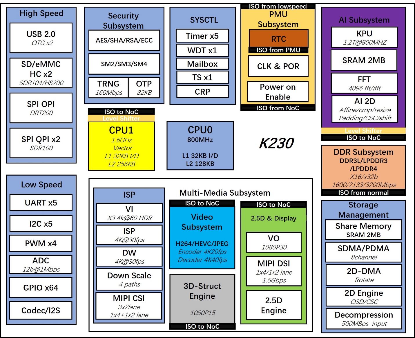

Chip Overview#
Chip Block Diagram#
Figure 1-1 K230 Block Diagram Figure 1-1 K230 Block Diagram

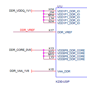

  • The DDR_ZN pin needs to be connected to a 240Ω (1%) calibration resistor to ground.
  • The DDR_RESET pin is left floating.
  • The chip has a built-in VREF circuit for the DDR controller, so the DDR_VREF pin needs to be left floating.

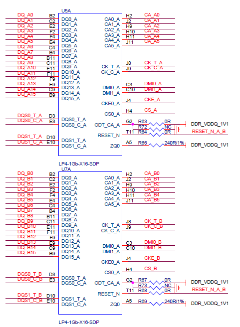

The circuit design of LPDDR4 refers to Figures 3-12, 3-13, 3-14, 3-15, and 3-16. Figure 3-12 K230 LPDDR4 Circuit Figure 3-12 K230 LPDDR4 Circuit Figure 3-13 K230 LPDDR4 Power Circuit Figure 3-13 K230 LPDDR4 Power Circuit Figure 3-14 K230 LPDDR4 Reference Voltage Circuit Figure 3-14 K230 LPDDR4 Reference Voltage Circuit Figure 3-15 LPDDR4 Chip Circuit Figure 3-16 LPDDR4 Chip Power Circuit Figure 3-16 LPDDR4 Chip Power Circuit
When using LPDDR4, note:
  • The schematic of the DDR PHY and each DRAM chip needs to be consistent with the reference design, including power decoupling capacitors.
  • The RESRT_N pin is directly connected to the corresponding pin of the chip.
  • When using LPDDR4 chips with K230, the VREF voltage is 0.6V, and it is recommended to use 1kΩ (1%) resistors for voltage division.

  • For the DDR chips used by the K230, the power supply must be on the same power network as the main chip.
  • Modules with the same voltage requirements can use the same power source if the voltage accuracy and current requirements are met. For applications with low precision requirements, analog modules like ADCs can also be connected to the power source used by digital modules after isolation.
  • The K230 integrates a DDR_Vref power supply for the chip’s DDR controller. For external chips, the reference design for the LPDDR3 VREF power supply is shown in Figure 3-39.
Figure 3-39 LPDDR3 Chip Vref Circuit Figure 3-39 LPDDR3 Chip Vref Circuit
It is recommended to use resistors with an accuracy of ±1%. The reference design for the external LPDDR4 VREF power supply is shown in Figure 3-40.
Figure 3-40 LPDDR4 Chip Vref Circuit Figure 3-40 LPDDR4 Chip Vref Circuit
The reference design for the K230D DDR module VREF power supply is shown in Figure 3-41.
Figure 3-41 K230D Version DDR Vref Circuit Figure 3-41 K230D Version DDR Vref Circuit
