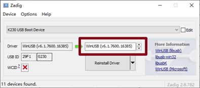

If it appears as shown below, you need to use zadig-2.8.exe to install the USB driver.
k230_usb_boot_device_driver
zadig

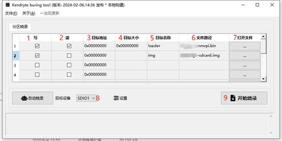

Download the k230_burntool software package and open the software.
interface_disc
The first row is for selecting loader.bin. You can open the file and select the loader.bin used by the corresponding device (the software package includes package_canmvpi, package_evb, package_canmvzero, etc.). loader.bin is a must, so the first row disables other editing permissions except for file selection to avoid user confusion.
1, The first column, select whether to perform a write operation. If you only need to read data from the device storage media, do not check it.
2, The second column, select whether to perform a read operation. If you only need to write data to the device storage media, do not check it. The read data is saved with the file name “file path + .target name,” such as fn_ug_u-boot.bin.uboot_a.
3, The third column, target address, the starting address of the storage media partition, whether flash or sd/emmc, is in bytes. The partition situation of sd/emmc firmware is related to K230_sdk/board/common/gen_image_cfg/genimage-sdcard.cfg.
4, The fourth column, target size. For sd/emmc/nor burning, if this item is empty, the software will use the actual size of the file. For nand, due to the mechanism of skipping bad blocks, the user needs to specify a partition size.
5, The fifth column, target name. Except for the first row of loader which is fixed, other partitions can be freely input as long as they are not repeated.
6, The sixth column, file path. This is the path of the burning partition file.
7, The seventh column, open file. Select the burning partition file.
8, Target device selection, SDIO0/SDIO1 can be connected to SD cards or emmc. NOR/NAND can be connected to spi0, spi1, or spi2.
9, Start burning. After configuring the previous options and putting the K230 chip in USB burning mode, click to start burning.

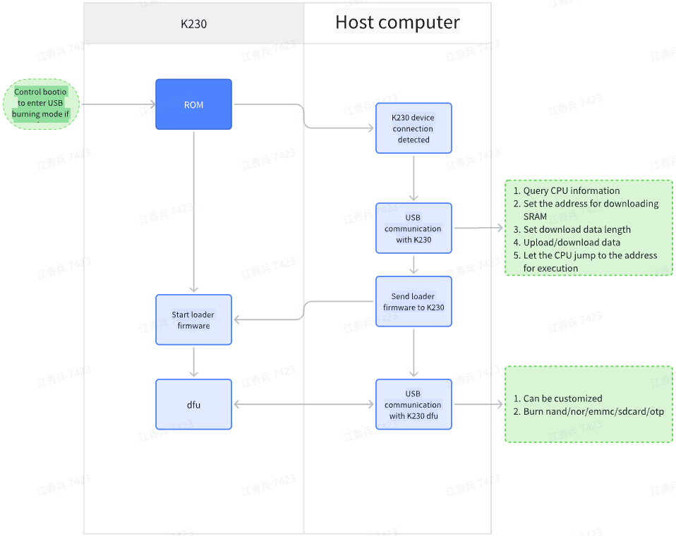

K230 USB Burning Mechanism#
k230_dfu
The USB burning function of K230 is implemented in bootrom. When the bootrom fails to start during the startup process, it will jump to the USB burning mode. For example, if the device uses an SD card as storage media, one solution is to switch to other media through bootio, so that K230 will enter USB burning mode when it fails to start. Another solution is to remove the SD card, so that K230 will also enter USB burning mode when it fails to start. For emmc/nand/nor devices, only the first solution can be adopted.
ROM only provides the function of downloading data to SRAM via USB and letting the CPU execute programs. The specific read/write driver for the storage media is implemented by loader.bin. loader.bin also performs DDR training operations.
Different devices have different DDR training, and the storage media solutions may vary, so different devices correspond to their respective loader.bin.
