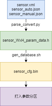

The production flowchart is as follows:
isp param
Figure 2-1 Parameter Partition Production Flowchart
The production steps are as follows:

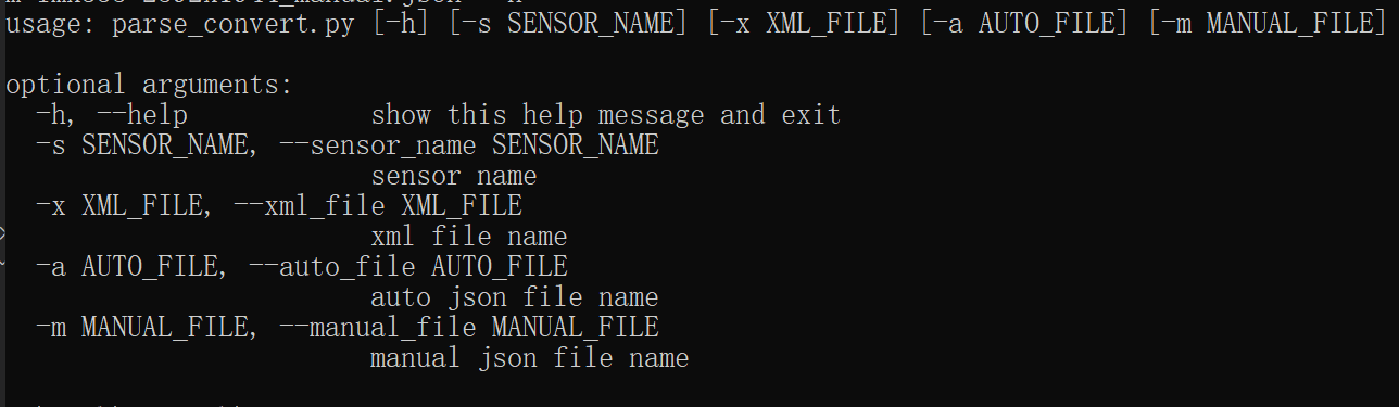

Execute the conversion header file tool parse_convert.py, parse and convert the three copied configuration files into a parameter header file (it is recommended to use python3.x for the conversion tool)
parse_convert

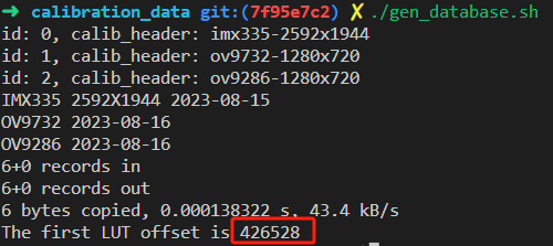

lut_offset: When has_lut is set to 1, this member is effective. The value corresponds to the offset of the dewarp parameter in the parameter partition. The specific calculation method is parameter partition base address + header size + parameter structure size + padding size. The parameter partition base address is defined as CONFIG_MEM_SENSOR_CFG_BASE in k_autoconf_comm.h. This definition varies with different compiled hardware. It can be calculated by the gen_database.sh script provided by the SDK. The execution will print the result:
calc_isp_param_data_size
Figure 2-2 Parameter Partition Automatically Calculates Dewarp Offset

    CONFIG_MEM_SENSOR_CFG_BASE + 426528, // 426528 is calculated by the script

The SDK provides a semi-automated script gen_database.sh that links processes 2.2.2.1 - 2.2.2.5. After completing the source code definitions for header, dewarp, and parameter parsing, users can execute this script to produce the binary file, or even compile the SDK directly without manually executing the script.

  1. When generating the parameter header file, the dewarp structure is default. Fill in based on actual conditions and calculate the offset. The offset can be automatically calculated by executing gen_database.sh and then filled into the corresponding position.
