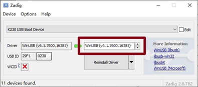

If the following situation occurs, you need to use zadig-2.8.exe to install the USB driver
k230_usb_boot_device_driver
zadig

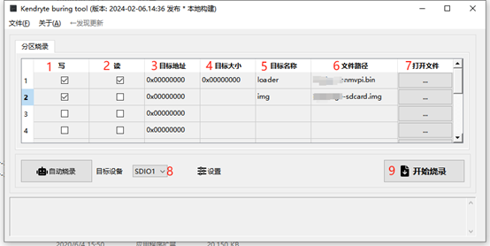

Download the k230_burntool software package and open the software
interface_disc
The first line is to select loader.bin. You can open the file and select the loader.bin used by the corresponding device (the software package contains loaders such as package_canmvpi package_evb package_canmvzero). loader.bin is required, so in the first line except file selection, other editing permissions are prohibited to avoid user difficulty in selection.
1, the first column, select whether to perform write operations. If you only need to read data from the device storage medium, do not check it.
2, in the second column, select whether to perform a read operation. If you only need to write data to the device storage medium, do not check it. The read data save file name is “file path +. target name”, such as fn_ug_u-boot.bin.uboot_a
3, the third column, target address, the starting address of the partition of the storage medium, whether flash or sd/emmc, is in bytes. The partition status of sd/emmc firmware is related to K230_sdk/board/common/gen_image_cfg/genimage-sdcard.cfg.
4, fourth column, target size. For sd/emmc/nor burning, if this item is empty, the software will use the actual size of the file. For nand, since there is a mechanism to skip bad blocks, the user needs to specify a partition size.
5, fifth column, target name. Except for the loader in the first line, which is fixed, other partitions can be entered at will, as long as they are not repeated.
6, sixth column, file path. That is, the path to burn the partition file
7, seventh column, open the file. Select burning partition file
8, target device selection, SDIO0/SDIO1 can be connected to either SD card or emmc. NOR/NAND can be connected to spi0 or spi1/spi2
9, start burning. After the previous options are configured and the k230 chip is in USB burning mode, click to start burning.

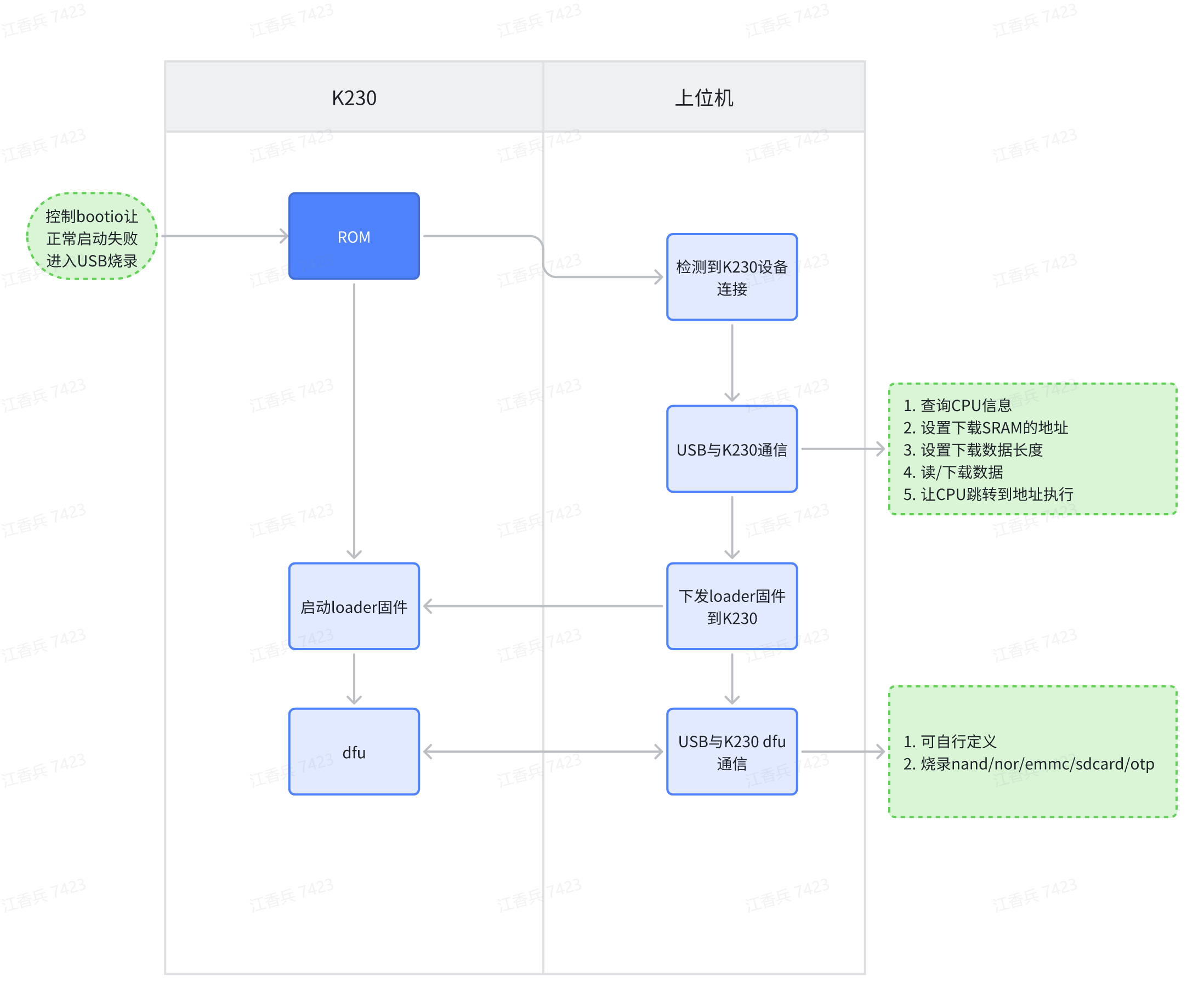

K230 USB burning mechanism#
k230_dfu
The USB burning function of K230 is implemented in bootrom. When the bootrom fails to start during the startup process, it will jump to USB burning mode. For example, if the device uses an SD card as the storage medium, one solution is to switch to other media through bootio. In this way, the k230 will enter the USB burning mode if it fails to start. Another solution is to pull out the SD card, so that the k230 will enter USB burning mode if it fails to start. For emmc/nand/nor devices, you can only use the first solution.
ROM only provides the function of USB downloading data to SRAM and letting the CPU execute programs. The specific read and write driver for storage media is implemented by loader.bin. loader.bin also performs ddr training operations.
Different devices have different DDR training, and the storage media solutions may be different, so different devices will correspond to their own loader.bin.
