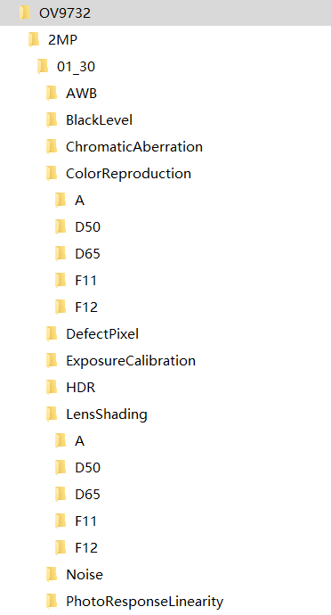

Setup Calibration File Folders with Calibration Parameters#
Please create folders for each resolution as the following steps:
  1. Create a folder using the sensor name (e.g., /OV9732)
  2. Create a sub-folder with the lens name (e.g., /2MP)
  3. Create a sub-folder with the sample name (e.g., /01_30)
  4. Create sub-folders for each of the calibration function (As shown in the following figure)
    Create sub-folders
  5. Copy calibration parameter file(s) into the corresponding parameter folder.
For example, for each resolution:
  • sensor
    • lens
      • sample
        • AWB
          • AWB parameters.txt
          • AWB parameters.mat
        • BlackLevel
          • BLS parameters.txt

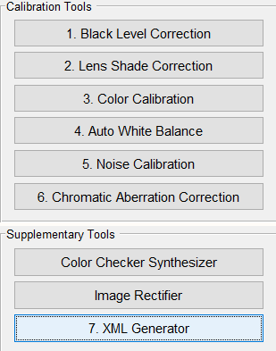

After copying all calibration parameter files to the corresponding folder, open the K230 ISP Calibration Tool and use it to generate an XML file.
As shown in the following figure, click the “7. XML Generator” button on the main interface:
main interface

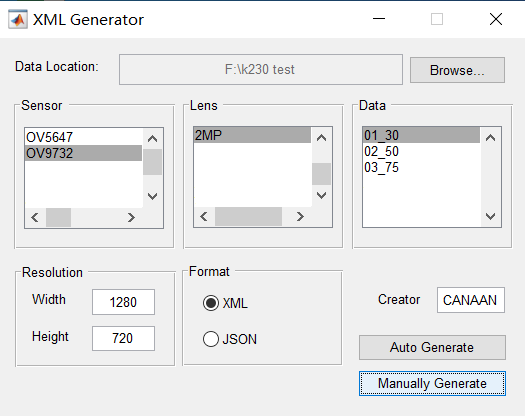

Pop up the “XML Generator” box as below:
XML Generator
Select the correct calibration directory address in the “Data Location” column, select the created sensor folder in the “Sensor” column, select the created lens folder in the “Lens” selection column, and select the created sample folder in the “Data” column.

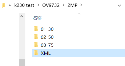

In the “Resolution” column, input the correct width and height of the image, select “XML” in the “Format” column, input the creator name in the “Creator” column, and then click “Manually Generate” to generate an “XML” subdirectory under the selected lens folder, which will generate an .xml file.
XML forlder
After renaming the generated XML file according to the input XML name in the K230 SDK (such as ov9732-1280x720.xml) code, place it in the config directory and it will be loaded correctly by the K230 SDK.
