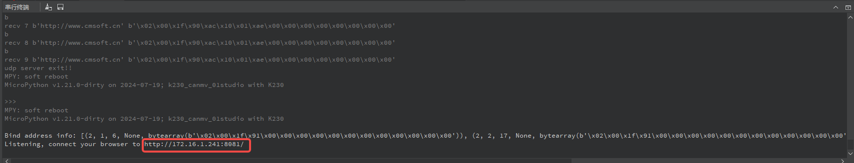

  1. Run the script and check the serial port output for http://<IP>:8081/.
  2. Open this address in a browser that can access the development board.
