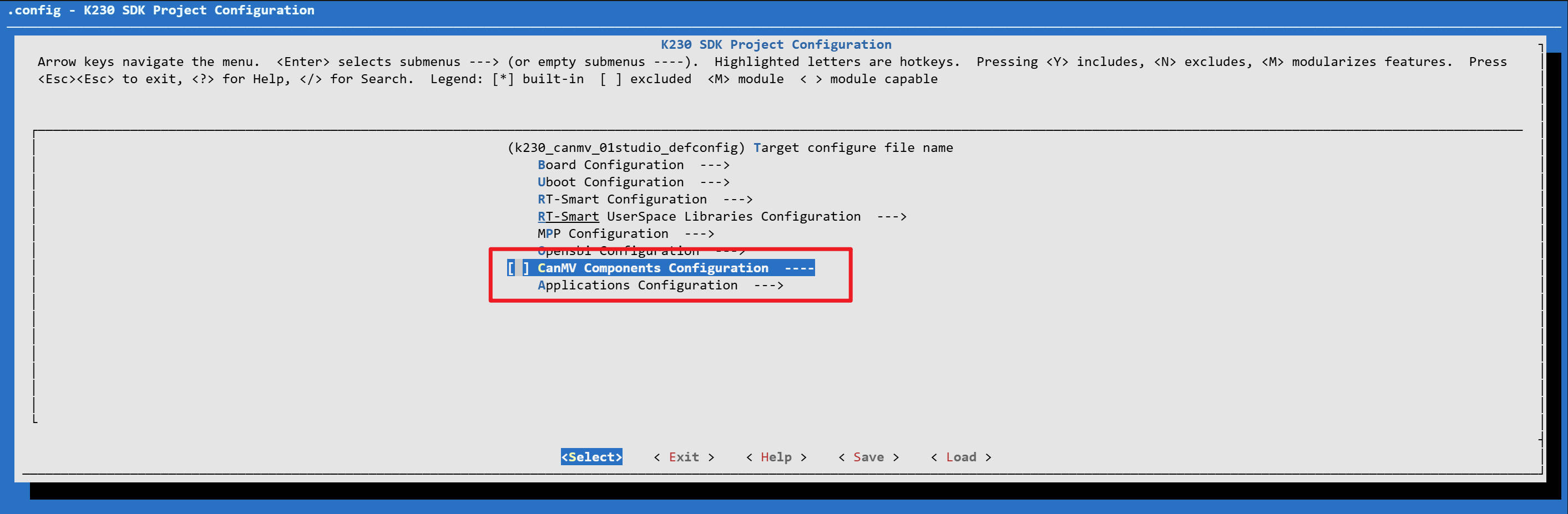

k230 make menuconfig # Interactive configuration
