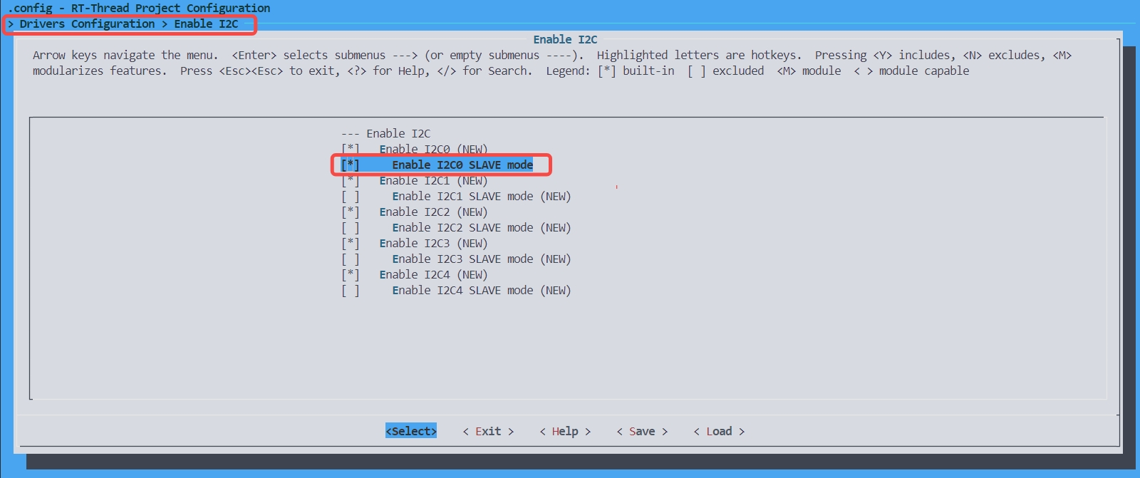

The K230 I2C controller defaults to master mode but can switch to slave mode through customized firmware. To enable slave mode, configure Enable I2Cx SLAVE mode using make rtsmart-menuconfig during firmware compilation (path: Drivers Configuration/Enable/I2C/Enable I2Cx/Enable I2Cx SLAVE mode), then recompile the firmware.
menuconfig
