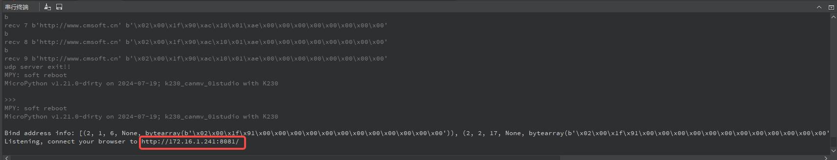

After running this example in the CanMV IDE K230, the IDE serial terminal will display the following information:
image-20240722134617332

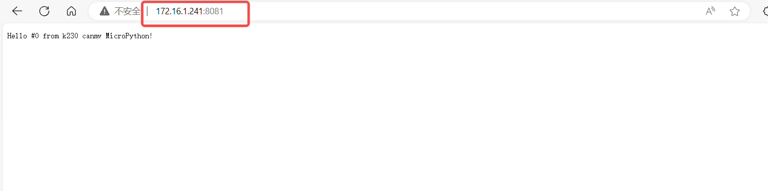

Copy the URL from the terminal and access it in your browser to view the server’s response:
image-20240722134912486
