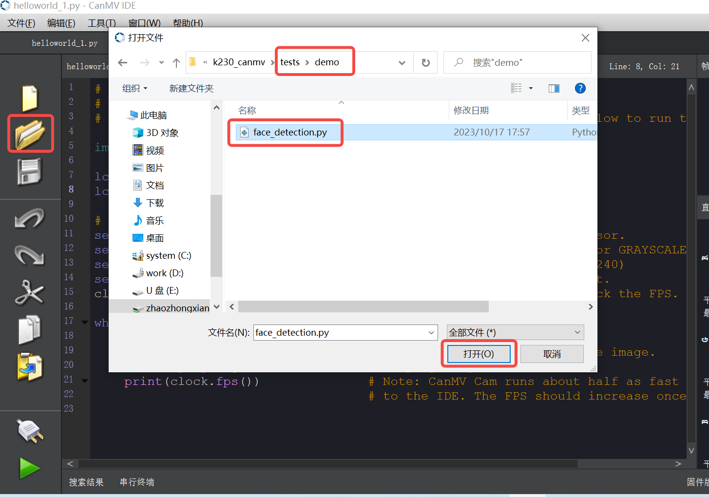

For users with versions prior to K230 CanMV V0.5, you can download the test programs from the following link and load them through the IDE: Test Program Download Link.
Open Script
Click the “Open” button in the IDE, select the downloaded test file, and open it. Then click the green “Run” button at the bottom left corner, and the program will start executing. After a short wait, the monitor will display images captured by the sensor. This example program is a face detection program, and you will see faces in the image being highlighted.

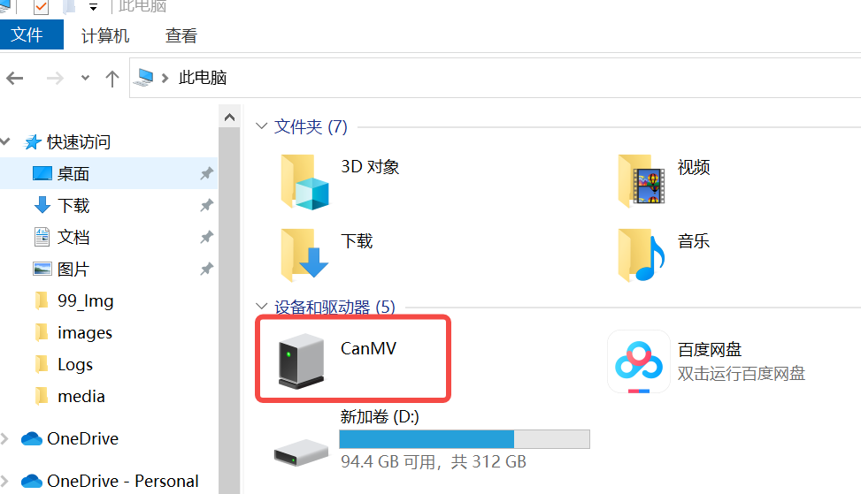

For versions K230 CanMV V0.5 and later, it is recommended to use the example programs in the virtual USB drive. After plugging in the development board, open “My Computer” or “This PC” on your computer, and a virtual USB drive named CanMV will appear under devices and drives.
Virtual USB Drive

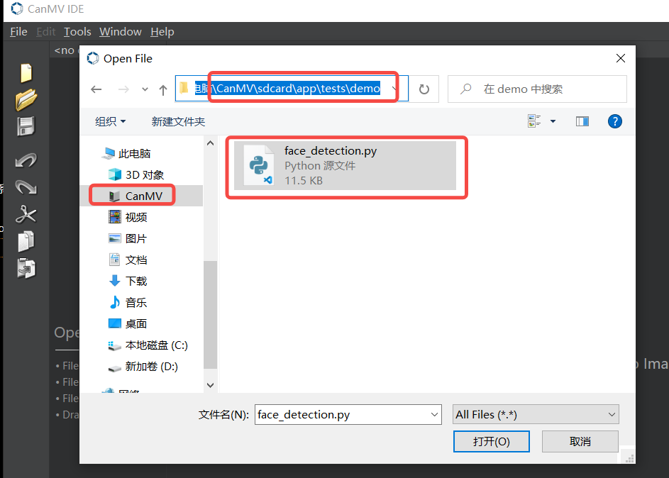

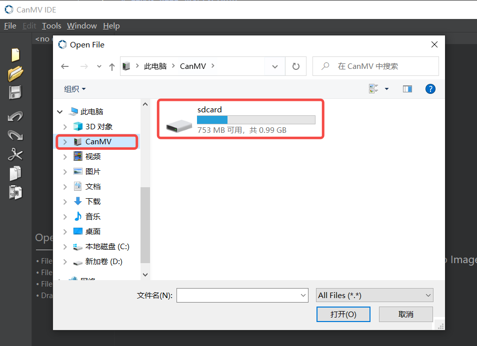

In the virtual USB drive, select and open the desired example script.
Open Example in Virtual USB Drive
For instance, to run the face detection example, you can find the corresponding script in the tests or examples directory.
Face Detection File
After running the program, the monitor will display the AI face detection demonstration results, with faces in the image automatically highlighted and marked.
