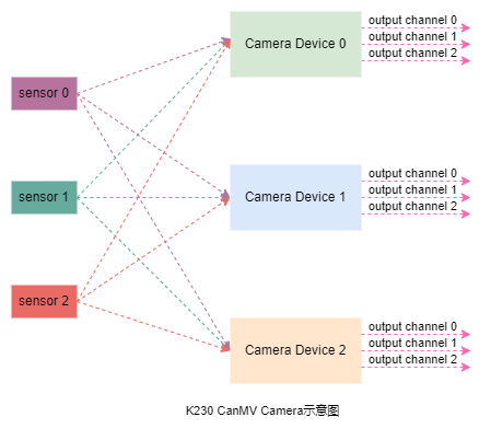

The sensor module on the CanMV K230 platform is responsible for image acquisition and data processing. This module provides a set of advanced APIs, allowing developers to easily obtain images in different formats and sizes without needing to understand the specifics of the underlying hardware implementation. The architecture is shown in the diagram below:
In the diagram, sensor 0, sensor 1, and sensor 2 represent three image input sensor devices; Camera Device 0, Camera Device 1, and Camera Device 2 correspond to the respective image processing units; output channel 0, output channel 1, and output channel 2 indicate that each image processing unit supports up to three output channels. Through software configuration, different sensor devices can be flexibly mapped to the corresponding image processing units.
The sensor module of the CanMV K230 supports simultaneous access of up to three image sensors, each of which can independently complete image data acquisition, capture, and processing. Additionally, each video channel can output three image data streams in parallel for further processing by backend modules. In practical applications, the number of supported sensors, input resolution, and the number of output channels are limited by the hardware configuration and memory size of the development board, so a comprehensive evaluation based on project requirements is necessary.
