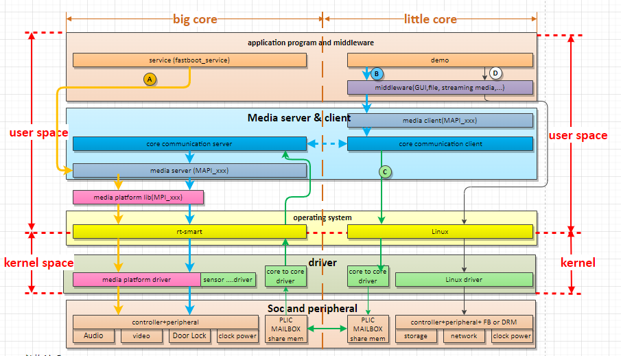

SDK software architecture overview#
The K230 SDK is a software development kit for the K230 development board, which contains the source code, toolchain and other related resources needed for development of Linux & RT-smart dual-core heterogeneous systems.
The K230 SDK software architecture hierarchy is shown in Figure 1-1:
sdk_architecture Figure 1-1 K230 SDK software architecture

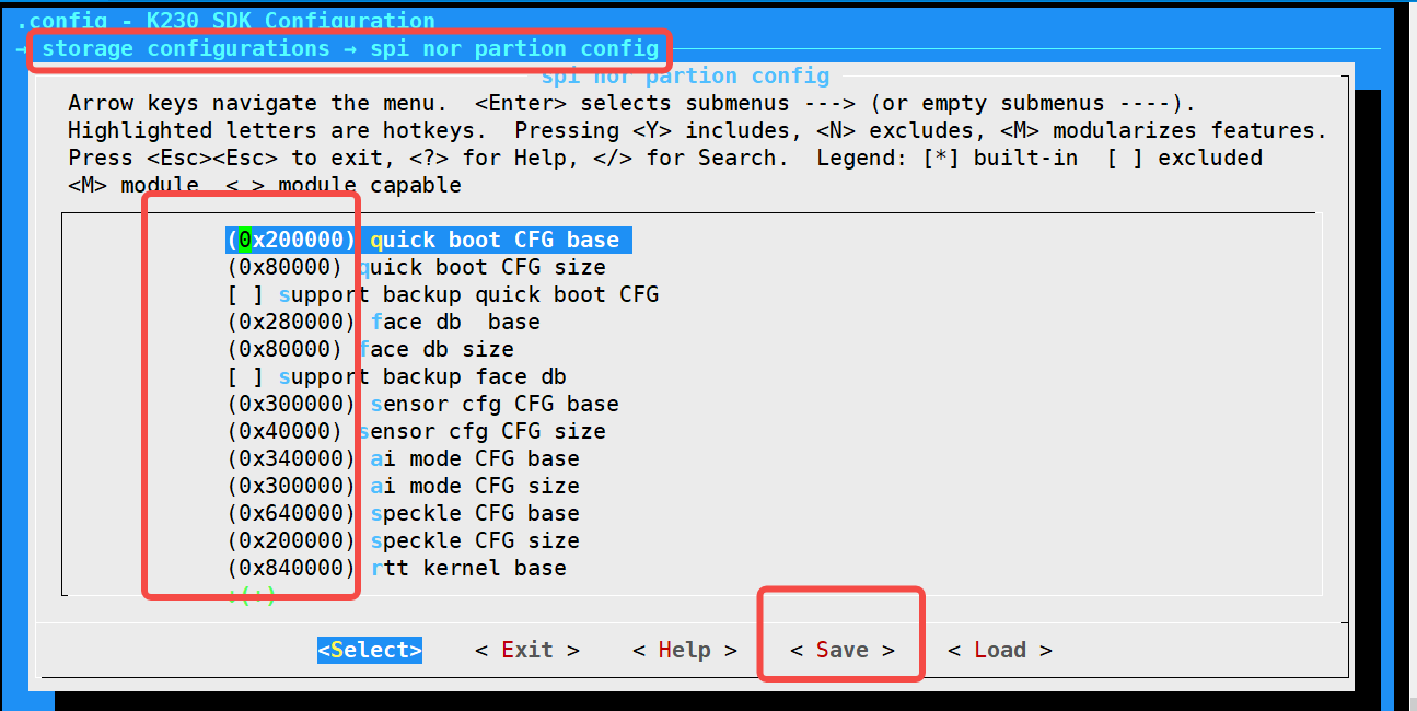

Execute make menuconfig —>storage configurations—>spi nor partion config in the sdk home directory to modify the partition (the interface is as follows); after modification, execute make build-image;
image-image-menuconfig_spi_nor_part
Modify the partition through menuconfig for detailed implementation instructions:
Make Menuconfig will generate .config after configuration (part of the content below)
The tools/menuconfig_to_code.sh script dynamically (the key scripts are below) modify the Linux device tree and board/common/gen_image_cfg/genimage-spinor .cfg files based on these definitions;

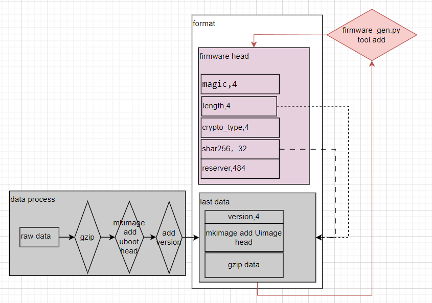

Partition data format and generation process#
At present, the data partitioned by parameters such as fast boot parameters, face data, sensor config, AI models, speckles, RTT, RTPp and other parameters are not encrypted, and the format and generation process are as follows:
flash part data format The main build scripts are as follows:
# For more detailed generation details, please read board/common/gen_image_script/gen_image_comm_func.sh file gen_cfg_part_bin
${k230_gzip} -f -k ${filename}  #gzip
sed -i -e "1s/\x08/\x09/"  ${filename}.gz
#add uboot head
${mkimage} -A riscv -O linux -T firmware -C gzip -a ${add} -e ${add} -n ${name}  -d ${filename}.gz  ${filename}.gzu;
python3  ${firmware_gen}   -i ${filename}.gzu -o fh_${filename} ${arg}; #add k230 firmware head
The corresponding execution process is printed as follows:

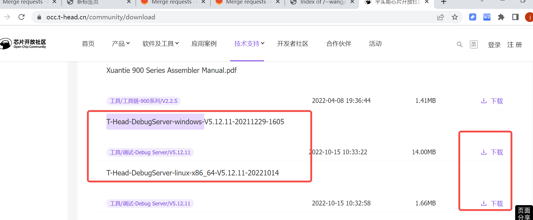

  1. Download the software and DebugServer User Guide v5.6 https://occ.t-head.cn/community/download from the T-Head PlatformT-Head-DebugServer, and install the software on your PC by referring to DebugServer User Guide v5.6T-Head-DebugServer
