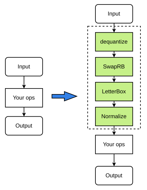

【Note】
  1. input range is the range of floating-point numbers, that is, if the input data type is uint8, input range is the range after dequantization to floating-point (can not be 0~1), which can be freely specified.
  2. input_shape needs to be specified according to the input_layout. Take [1,224,224,3] for example. If the input_layout is NCHW, the input_shape needs to be specified [1,3,224,224]. If input_layout is NHWC, the input_shape needs to be specified as[1,224,224,3]
  3. mean and std are parameters for normalize floating-point numbers, which users can freely specify.
  4. When using the letterbox function, you need to limit the input size to 1.5MB, and the size of a single channel to 0.75MB.
For example:
  1. The input data type is uint8, input_range set to [0,255], then the function of dequantization is only to perform type conversion, convert the data of uint8 to float32, and the mean and std parameters can still be specified according to the data of 0~255
  2. If the input data type is uint8 and input_range is [0,1], the [0,1] fixed-point number will be dequantized to a floating-point number of [0,1], mean and std need to be specified according to the new floating-point range.
The pre-processing process is as follows (all green nodes in the figure are optional):
Pre-processing process
